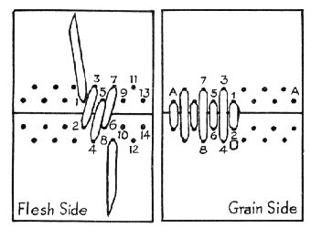

Method 1 - Single Row
For belts less than 8" wide
Punch a single row of holes in each end of the belt, totaling an ODD number of holes on each row and uniformly spaced across the width. Sufficient space should be left between the holes and the edge to prevent tearing. In general, the holes should be kept 1/2" from the edge of the belt and spaced so that there is not less than 1/2" of leather between holes.
Butt ends of belt together with their pulley (grain) sides up. Put lace down through holes No. 3 and No. 8 from the pulley side, drawing the ends of the lace even.
LacingBelts
For end A of the lace:
Up throughDown through
38
49
510
510
49
3
Cut slit with awl at N 1/2" back of hole No. 3 and push lace through. Cut off the ends of the lace a short distance from the belt surface, then slightly cut the stub end at the belt, twist and hammer down.
For end B of the lace:
72
61
61
72
8
Cut slit with awl at N back of hole No. 8 and fasten as for end A.
The illustration shows five holes to each row. The method is the same for any odd number of holes - always start with the center holes.

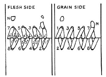

Method 2 - Hinge Joint
For any width belt
Punch a single row of holes in each end of the belt, uniformly spaced across the width. Sufficient space should be left between the holes and the edge to prevent tearing. In general, the holes should be kept 1/2" from the edge of the belt and spaced so that there is not less than 1/2" of leather between holes.
LacingBelts
Butt ends of belt together with their outside (flesh) sides up. Fastening one end of the lace in two slots (made with an awl) above hole No. 1, pass the lace as follows:
Down throughUp through
11-1
22-1
11-2
22-2
33-1
44-1
33-2
44-2
55-1
66-1
55-2
66-2
77-1
88-1
77-2
88-2
7
Punch hole with awl and bring the end up at N, and cut off.

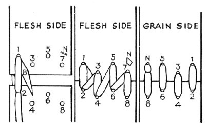

Method 3 - Double Row
Punch two rows of holes in each end of the belt. The holes should be exactly opposite. Sufficient space should be left between the holes and the edge to prevent tearing. In general, the holes should be kept 1/2" from the edge of the belt and spaced so that there is not less than 1/2" of leather between holes.
LacingBelts
Butt ends of belt together with their outside (flesh) sides up. Pass the lace as follows:
12
12
34
34
56
56
78
78
7

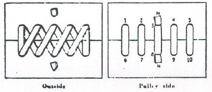

Method 4 - Heavy Duty Double Row
For belts more than 8" wide
Draw two lines across the belt, the first 3/4" from the end, the second 1-3/4" from the end. The first holes AA, are 5/8" from the side. In the intervening space located other holes approximately 1" apart. Punch other holes in the second line, staggering them with the first row. In preparing the other end of the belt, be careful to have the holes precisely opposite.
LacingBelts
Begin lacing by pushing the two ends of the lace through holes No. 1 and 2 from the grain (pulley) side, drawing it snug. Push the lace from No. 2 hole down through hole No. 3 and up through No. 4. The lacing continues as follows:
56
78
910
1112
1314
13 (a second time)14
1112
910
78
56
34
12
Now punch a slit half an inch back from hole No. 2, push the lace down through, then make another slit 1/2" back of the first one, pull the lace up, draw it tightly and cut off close.
The other half of the belt is laced in the same manner, ending and disposing of the loose end by tucking through slits on the opposite side from No. 1. In lacing, keep the laces at equal tension so the strain may be evenly distributed to each hole.
