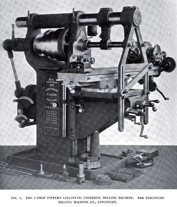

      The general appearance of the machine itself as now made by the firm, is seen in fig. 1.

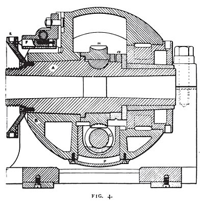

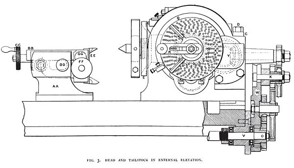

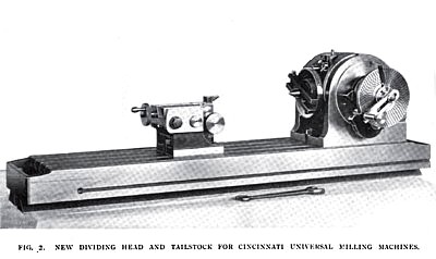

      The head and back centre, are shown in the photo fig. 2, while the detail drawings of the head are given in figs. 3, 4, 5. Fig. 3 illustrates the head and tailstock in external elevation, and figs. 4 and 5 are sections of the former in the longitudinal and transverse directions respectively.
Headstock (Side view)
 Headstock (Front view)
Distinctive features of this design are the following :—
The swivelling block, A, which carries the spindle, B, makes a complete revolution in the vertical direction. This it has in common with some other modern heads, but in general the movements of heads are confined to angles ranging from 10 deg. below the horizontal and 10 deg. beyond the perpendicular. And when cutting spirals the movement is still large, ranging between 5 deg. below the horizontal to 50 deg. beyond the perpendicular. The capacity for complete revolution is in some cases an advantage, because it permits of the cutting of right- and left-hand work without changing the cutter, and the cutting of the same piece of work on either side of the perpendicular. Moreover, the swivelling block is contained wholly within its bearings at whatever angle it may be set. By means of a new clamping arrangement it is held securely in any position without strain being thrown on the spindle. This comprises two trunnion bearings on the swivelling block, embraced by the clamping rings, C, pinched by two cap screws, D, the action being similar to that of clamping a shaft tightly in its bearings. In this case the circumference of the trunnion is very large, with the result that no disturbing influence can possibly affect the spindle or the worm gear. The edge of the swivelling block is of course graduated into degrees. The spindle, A, is provided with a clamp ring at it, which secures it endwise, and does not disturb its accuracy. The coned bearing neck at the front and the coned bushing at the back afford provision for taking up wear. The hollow spindle has a tapered hole in front.
THE DIVIDING MECHANISMS.
      These include the worm and wheel, and a special and very convenient index plate, E. The latter is used for getting low numbers in order to avoid the risk of mistakes that sometimes occur in counting the number of turns of the worm for low numbers. Divisions under 40 are obtained with this plate. On all divisions of 40 and over, more than one turn of the worm is not required.
      The plate, E, for direct indexing, is dish shaped, and has three circles of holes, 24, 30, and 36 on the back, in a position where they are protected from dirt and chips. This, with the adjustable pin, F, is seen in sectional detail in fig. 4. The pin holes for 4 and 6 divisions, which are so frequently required for fluting, nut-making, etc., have their positions indicated on the edge by figs. 4 and 6, so saving the trouble of counting the holes. This plate has a further and subsidiary utility, since when it lies in a position approaching to the vertical it affords protection to the cutting head from falling chips and oil.

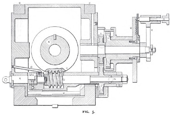

DISCONNECTION OF WORM AND WHEEL AND THEIR ADJUSTMENTS.
      The worm, G, and its wheel, H, are seen in gear with each other in the drawings. To effect their disconnection the worm is dropped bodily in its bearing or case, J. This, it must be noted, is a vertical movement only, and not an eccentric one. It is effected by the eccentric pin, K, that moves the case bodily up or down. As the latter is confined sideways, the eccentric end of the pin is inserted in a bushing, L, which has endlong motion in the worm case, and so produces the motion.
      The screws, M, tie the worm case to the block above, which is drilled for L, and by means of these screws the worm is adjusted to the wheel. This is a straight line movement, as it should be. At the other end the worm case swivels about the pin, N, as a centre.
There are thus two separate adjustments provided, and each in a straight line, that for taking up wear by the screws M, and that for engagement and disengagement by the lever, K, and sliding pin, L, both of which are ideal arrangements, theoretically correct.
      The worm is single-threaded, and righthanded, with two and a half threads per inch. It runs in a bath of oil supplied through the tube, O. The cap, P, can be removed for purposes of cleaning and examination. The wheel has the usual forty teeth, so that forty turns of the handle, R, move it through one revolution. Both it and the index plate are of good size.

      The dividing or indexing head is used on plain milling machines as on universals, but the change gears for spiral work only upon the latter. The illustrations, figs. 3 and 5, render this distinction clear. In fig. 5 the revolution of the handle or index pointer, R, turns the worm and its wheel through equal gears, S, T. When spirals are being cut the worm is driven through the gear, U.
THE CHANGE GEARS.
      The connecting up of change wheels from the lead screw, V, is illustrated in fig. 3, W being the swing plate, and X one of the two studs for compounding trains. The motion is transmitted to the spindle at right angles by the bevel wheels, V, actuating the spur wheels shown in fig. 5. The dotted lines of these bevel wheels are seen in fig. 3, in which details may be noted, by the way, of the ball thrusts to the lead screw, Woodruff keys to the worm wheel, and some of the fixed gears; also a fine adjustment of the index plate by ratchet and pin for resetting work. But we must now give some attention to the methods of operating this piece of mechanism.

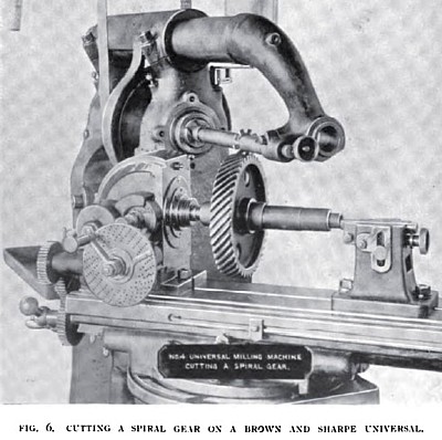

      Fig. 6 illustrates the cutting of a spiral gear on one of the Brown and Sharpe universals. In this head the spindle is rotated in a curved seating in which it is clamped. The spindle can be rotated independently by the worm and wheel, since the worm can be thrown out of gear with the wheel by an eccentric bushing. The spindle may then be turned by hand and locked by the index plate and pin. In the head for the No. 1 or smallest machine, steel bushings afford a bearing for the worm shaft, and a pivot for the spindle box, and the front end of the latter is set by suitable graduations to any angle from 5 deg. below the horizontal to the perpendicular. In these heads the worm wheel has forty teeth, and the worm is a single-threaded one.

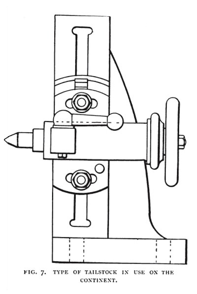

 Tailstock used on the Continent
      A different type of tailstock, fig. 7, is common on the Continent. It comprises an upright on which a swivelling block that carries the centre is adjustable vertically, a screw being frequently used for convenience of moving the block. The latter is made to swivel for the purpose of supporting the outer end of taper work, when the taper is long, and the angle large. It provides the same movements as the American and English patterns, but a screw is used instead of a rack for the vertical movement, and the mechanism is entirely different.

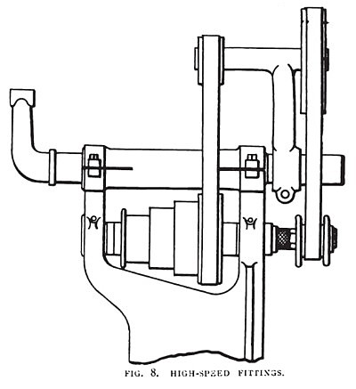

The high speed fitting, fig. 8, is used for light end mills chiefly. It comprises a spindle which runs in a shell that fits the taper hole in the main spindle. It is driven by a belt from above, which is operated by a belt and pulley driven from the headstock main cones. The pulleys have their bearings in a bracket, which is clamped on the overhanging arm standing above it, or some equivalent device. Speeds of over 1,500 revolutions per minute are thus obtainable.       In a rack cutting attachment a pair of bevel gears changes direction of motion from the spindle to the rack cutting spindle and arbor running parallel with the table. The advantage of changing the axis is that there is no limit then to the length of rack it is possible to cut. The racks are held in a specially long vise. By fitting a slitting cutter, stock can be sawn off by the same attachment.

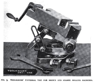

      Rectangular vises are made in various designs to bolt to the machine tables to hold work parallel with or at right angles to the table, to swivel to horizontal angles or to vertical angles, and having graduated edges.
Toolmakers Universal Vise
      One of these, by Brown and Sharpe, is shown in fig. 9.
