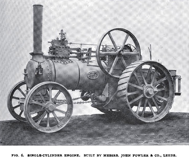

      Fig. 6 represents one of Messrs. Fowler's single-cylinder, general-purpose traction engines. The illustration is self-explanatory. All the best features of a modern traction engine intended for threshing and general work are embodied in this example. The high speed governor and equilibrium throttle valve render the engine particularly suitable for steady driving.

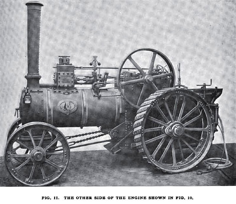

      In Figs. 10 and 11 are shown both sides of a very well designed agricultural locomotive, made by the well known firm Messrs. Marshall, Sons & Co., of Gainsborough. These traction engines have been improved from time to time and possess all the latest devices suggested by a long experience. It is impossible to speak too highly of the efficiency and good workmanship of Messrs. Marshall's productions. The cylinder is thoroughly steam-jacketed, and the steam supply, the circulation and the drainage of the jacket have received careful attention. Bored guides are used instead of the usual slide bars, and the outer end is supported by a bracket that serves as a guide for the valve rod, and a stand for the governor and throttle valve spindle, as well as for the details of the reversing gear.
      The sides of the tender are flanged so as to reduce the riveting, increase the strength and give the tender a neater appearance. Some of the gearing is placed in the box bracket; the remaining gearing outside the plate is effectively covered in to protect it from dust and dirt. The steerage worm wheel is placed inside the bearing, instead of outside, as is the usual practice. The engine is fitted with strong compensating gear, a slip winding drum and all the usual tools and appliances for rendering the engine complete and ready for any emergency to be met with in regular threshing or occasional hauling work.

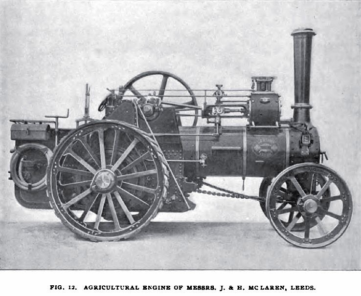

      Another prominent firm engaged in the manufacture of traction engines, is Messrs. J. & H. McLaren, of Leeds. In Fig. 12 is shown one of their newly designed agricultural locomotives. This engine is of the four-shaft type. The weight of the engine has been considerably reduced, in fact there is a desire among the best makers to take away all superfluous material in the details and to replace heavy cast-iron brackets with much lighter ones made of steel. By these alterations the strength and the efficiency of the engines are considerably increased. Messrs. McLaren, too, have adopted the bored guide. The engine is a thoroughly sound and trustworthy piece of workmanship, the design embodying the improvements suggested by seventeen years' experience.

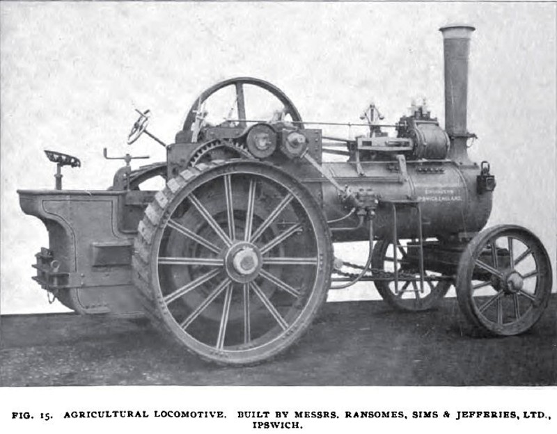

      Fig. 15 shows one of Messrs. Ransomes, Sims & Jefferies' improved agricultural locomotives of the single-cylinder type. A large number of these engines have been manufactured and are doing excellent service on farms.
      A few years ago there was every in dictation that the compound traction engine would become very popular, but this result has hardly been realized. The compound engine has been adopted in many cases, but those makers who have specially boomed their compound engines still continue to make a good number of single-cylinder engines. Some firms say, "We can supply traction engines made on the compound principle, but we recommend the single cylinder engines, as, with the latest improvements, they work very economically and have only half the number of parts." There are other manufacturers who are prepared to supply compound engines, but who are rarely asked for them. The greater proportion of their orders are for single-cylinder engines. For continuous hauling work, however, the compound engine must be recommended. If this type of engine is worked at the full boiler pressure of 150 lbs. per square inch, a saving of thirty per cent, in fuel and water will be secured. The noise produced by the exhaust steam also is reduced, which is an advantage. The shocks upon the crank-pins, gearing and other working parts are less severe. An auxiliary valve is provided which allows high pressure steam to enter both steam chests, and both the cylinders exhaust into a common exit pipe (the compound principle being suspended for the moment), enabling the engine to start readily with a heavy load behind. As soon as the engine is under way the valve is closed. A relief valve is fixed on the low-pressure steam chest.
      For threshing purposes the compound engine cannot be so fully recommended on account of the reduced steam pressure employed for threshing,—from 80 to 100 lbs. pressure being quite sufficient. Not only so, but for this work the attendants are often very unskillful, so that it is an advantage to have the simplest possible engine. The first cost is also a consideration with the threshing fraternity. While on the subject of cylinders we may refer to the proposal to bolt the cylinder on a wrought steel fixing or girder, instead of bolting the casting direct to the boiler barrel as heretofore. The base of the cylinder and the seating are planed, so that, having a flat surface, the joint is more easily made and retained. None of the bolts pass into the steam space. For export engines this method of construction possesses important advantages. Beyond this there does not seem to be any great value in the plan. Now that steam pressures are steadily creeping up, some makers have experienced trouble in keeping the joint tight under the cylinder, around the steam inlet, but if the joint is properly fitted there will be no fear of leakage. In Fig. 16 is given a section of a traction engine cylinder in order to show the steam opening from the boiler, and one method of making a steam tight joint. It will be seen that the cylinder is tapped to receive a pipe which passes through the boiler plate; on the under side of the plate a properly shaped washer is fitted, and a nut is screwed tightly up to it On the bottom end of the pipe a steam collector is also screwed.

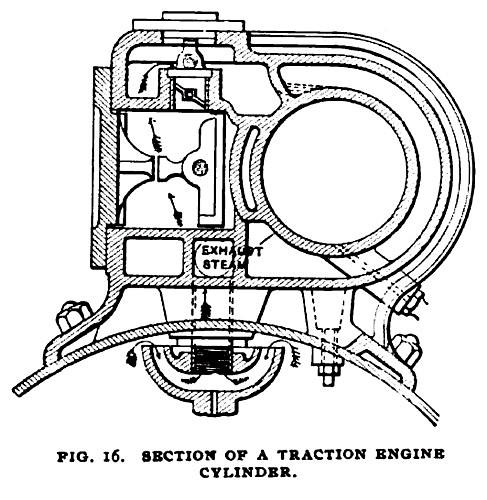

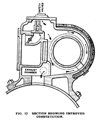

      In Messr’s Ransomes’ traction engines this steam joint trouble is nicely remedied. The cylinders in their engines have no steam inlet hole under the foot, but the steam is conducted into the cylinder by a separate elbow so arranged that the joint is easily made and rarely leaks after it is once fixed in position. The bolts around the cylinder foot have to make their own joint only, and if the bolts are turned taper under the head and fit the holes in the boiler plate, iron to iron, without red lead, they will never leak.

The cylinders are always steam jacketed. The outside shell is generally made of good iron, and the liner is made of specially hard iron and is forced into its place by hydraulic pressure, the annular space between the liner and the shell forming a roomy jacket, as shown in Fig. 17. This jacket space communicates direct with a chamber on the top of the cylinder, which answers the same purpose as a dome. By the arrangement shown, circulation of the jacket steam is secured.
      The steam chests of compound engines are often placed on the outside, so as to be easy of access for examination. When placed between the cylinders, they are troublesome to get at, unless they are arranged some distance above the centre line of the cylinders, in fact, as near to the top of the cylinder as possible, the valve rods and valve faces being inclined so as to point to the centre of the crankshaft. The enormous friction of a large slide valve for a single-cylinder traction engine has been obviated by the application of the compound engine; the high pressure slide valve is of small dimensions, and, working on the compound principle, it is partially balanced. For want of space we have been compelled to omit some remarks with illustrations of rigid wheels, compensating gear, winding drums and driving gearing. We illustrate, however, at least one form of spring wheel. Inventors from the earliest times have been busy devising spring wheels for traction engines. Some of these answered well, and many were made, of a few different types, but most of them soon showed some constructional defect,—generally in the quality of the steel of which the springs were made. The constant jar on the road caused the material to become so brittle that the spring spokes, or the volute springs between the arms and the tires of the wheels, sooner or later gave way, and there are very few spring wheels at work at the present time.
