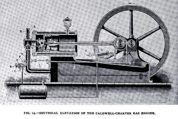

      Such provision is made in the case of the Otto engine, as described in the preceding paper, and also in that of the Caldwell-Charter gas engine, built by the H. W. Caldwell & Son Company, Chicago, Ill., and shown in perspective and in sectional elevation, respectively, in Figs. 13 and 14. In both these views the engine is represented as arranged for the use of gasoline. In Fig. 14, A is the working cylinder; B, the piston; C, the inlet valve to the cylinder; D, the mixing chamber; E, a gasoline pump; E, an air-gate worked by the rod J, which, in turn, is operated by the governor; K, a gasoline supply regulating valve; H, a gasoline tank; NN, pipe from gasoline pump to a brass pan or reservoir, P; 0, a supply pipe from gasoline tank to pump; Q, the ignition tube; and R, the chimney surrounding it; I and L are air suction pipes taking their air supply from the hollow base of the engine.
      The pump E works constantly and keeps the gasoline in the small brass pan, P, which holds about a quarter pint, at a level fixed by an overflow pipe, which returns the surplus to the supply tank. The air-gate F is a brass plate, having two holes so arranged that in normal position a free passage of air is allowed through pipe I. When the governor opens the air-gate, the pipe I is closed and the air is sucked through pipe L. In this pipe is a nozzle leading to the pan P, and the passing air draws from nozzle the proper amount of gasoline and forms a combustible mixture of gasoline and air. Each suction takes fresh gasoline from the reservoir, always the same quantity as controlled by supply or throttle-valve K, and the charges of gas are therefore of equal strength and value. The ignition tube Q is kept at a uniform heat by a simple gasoline burner, furnished with engine. This tube is surrounded by the asbestos lined chimney R, which retains the heat. The governor is arranged on the crank-shaft; and through the rod J operates the air-gate F as already intimated. The exhaust valve, shown at the side of the cylinder, is controlled by a spring and a rod, receiving motion from the larger of two gear wheels. This gear wheel, as will be understood, is twice as large as the smaller driving pinion on the main shaft, and, therefore, makes only half as many revolutions as the latter, thus, of course, opening the exhaust valve only once in every two revolutions of the shaft. The engine, it would seem almost unnecessary to state, works on the Otto cycle. A water jacket, as usual, surrounds the cylinder. The engine, when intended for the use of gas instead of gasoline, dispenses with the gasoline pump and tank, and one of the suction pipes is connected with a gas supply pipe, in which a gas valve is located. It will be seen, therefore, that at a slight expense the gasoline engine can be changed to a gas engine, or vice versa.
      A 95 indicated horse-power Caldwell-Charter gasoline engine, developing 65 actual horse-power, is now furnishing power for a large grain elevator at Camden, N. J., and is said to give entire satisfaction. For such large engines the makers supply a self-starter, consisting of a hand pump for forcing a charge into the cylinder, and a detonator for exploding the charge after it has been introduced. This gives the engine its first impulse, after which it continues to operate with its automatic gear.

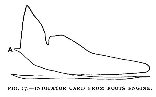

      Just how this manner of working affects the diagram is shown in Fig. 17, which is a sample indicator card. After the first explosion, it is seen, the pressure begins to fall, and when the port an to the compression chamber containing gas at a low pressure begins to open, this fall is accentuated, but very soon the fresh charge in the chamber is fired, and the pressure line rises again, and is well maintained for a considerable proportion of the stroke. At the end of the working stroke the exhaust valve is opened by the action of an eccentric.
      The peculiar system of compression is claimed by the makers to effect a considerable economy of working. The degree of compression in the special chamber amounting to about 120 pounds per square inch. This is considerably more than is ordinarily attained in gas engine compression.

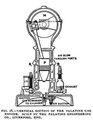

      A novel form of gas engine built by the Palatine Engineering Company of Liverpool, England, is shown in Figs. 18, 19 and 20, which represent vertical sections and an elevation. The engine is of the vertical type, and the crank and connecting rod are completely cased in. An air inlet valve admits air into the enclosed space when the piston descends. This air is slightly compressed on the up-stroke, and when the piston reaches the top of the stroke, a quantity of this compressed air rushes into the cylinder through air blow—through ports, the cylindrical part of the piston being then above these ports—see Figs. 18 and 19. At this moment the exhaust valve is opened by the lever L, Fig. 20, which is operated by one of the cams on the spindle driven by the wheel W. The Cylinder is thus completely swept out by a charge of fresh air. Referring to Fig. 18 it will be seen that the air suction valve is placed in the space below the cylinder and close to the gas admission. The gas is taken into the gas pump, Figs. 19 and 20, and the quantity admitted is determined by the governor and detent. Fig. 19, which control the admission of the gas to the pump by means of the small gas valve.
      Ignition of the charge is effected by a tube igniter, I T, and the moment at which the charge is permitted to enter the tube is controlled by a valve I V; worked by the lever L, Fig. 20. The engine, it will be noted, works on the Otto cycle.

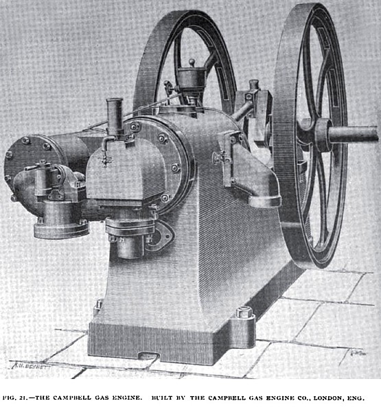

      The Campbell engine made by the Campbell Gas Engine Company, London, shown in Fig. 21, is designed to work according to a cycle in which there is an explosion at each revolution, twice as many, therefore, as in an engine working on the Otto cycle.
      This effect is attained by taking in the charge of gas and air by means of a pump, instead of by the action of the main piston. This pump is driven off a crank-pin in the side of the flywheel, and draws in gas and air through ports, controlled by a slide valve. There is a straight connection between the pump and the working cylinder, interrupted only by a simple non-return valve. The compressing action of the pump on the back stroke is so timed that the mixture attains a pressure of from six to ten pounds, just as the main piston passes an exhaust port in the side of the cylinder, and allows the expanded, acting charge to escape. The new charge then lifts the valve and enters the cylinder, driving the remaining products of combustion before it through the exhaust valve. On the return stroke of the main piston the charge is compressed, and at the commencement of the next stroke, it is fired by a tube igniter.

      The several indicator cards, Fig. 23, clearly show the effect of igniting gas mixtures of varying quantity in the engine. So far as structural features are concerned, it will be noticed from the perspective view of the engine that the cylinder does not overhang, as in most gas engines, and the cylinder jacket, engine bed and crank bearings are all cast together in one solid piece.

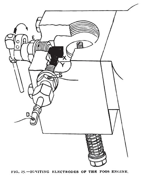

The arrangement of these will be better understood from Fig. 25. When the two ends X and Y are brought together, as shown in this illustration, the electric current from the battery provided with the engine is closed, and when they are then quickly separated, a spark is produced, and the gas or vapor charged is exploded.
      The connection and separation of the points of the electrodes is caused by the revolving motion of electrode E, Fig. 24, the end of which is made in the shape of a half circle as shown at X in Fig. 25, bringing the points X and Y together at every revolution of electrode E. Electrode D is made to screw further in so that when the inside end Y is worn off it can still be kept in contact with electrode E at X. Care must be taken not to screw it in so far but that there will be a separation of an eighth of an inch between the points of the two electrodes at every revolution of electrode E. The latter is worked from the main shaft through the intervention of two gear wheels and the rod f, the secondary gear wheel K being twice the size of the one mounted on the driving shaft, and, hence, making only half as many revolutions. It follows, therefore, that the electrode end X (Fig. 25), will revolve once for every two revolutions of the engine shaft, and, accordingly, will produce an igniting spark once for every two such revolutions.

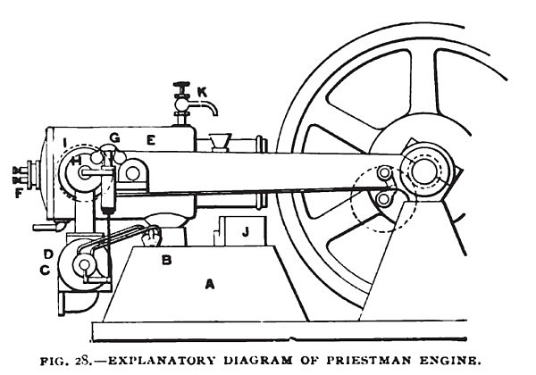

      The diagram shown in Fig. 28 more clearly explains the operation of the engine. In this illustration, A represents an oil tank filled with any ordinary high test (usually 150 degrees test) oil, from which oil under air pressure is forced through a pipe to the three-way cock, B, and is thence conveyed to the atomizer C, where the oil is met by a current of air and broken up into atoms and sprayed into the mixer D. It is there mixed with the proper proportion of supplementary air and sufficiently heated by the exhaust from the cylinder passing around this chamber. The mixture is then drawn by suction through the inlet valve I into the cylinder E where it is compressed by the piston and ignited by an electric spark passing between the points of the ignition plug F. the current for the spark being supplied from an ordinary battery furnished with the engine. The governor G controls the supply of oil and air proportionately to the work performed.
      The burnt products are then discharged through the exhaust valve H, which is actuated by a cam. The inlet valve I is directly opposite the exhaust valve. The air pump j is used to maintain a small pressure in the oil tank to form the spray. K is the water jacket outlet.
