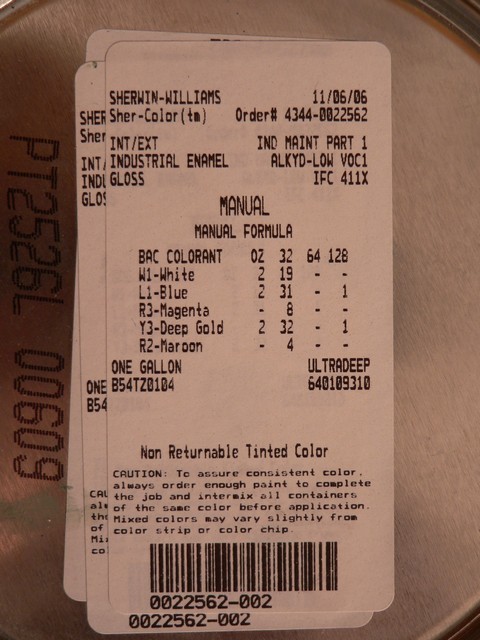

Alan Ciemian had a Sherwin Williams Industrial Enamel color-matched to the small belt guard of his Vista Green Powermatic 50 jointer:
http://www.owwm.org/viewtopic.php?t=21827Below is the formula:
Sherwin-Williams | Order# 4344-0022562 |
Industrial Enamel | Alkyd Low-VOC1 |
Gloss | IFC 411X |
BAC Colorant | OZ | 32 | 64 | 128 |
W1-White | 2 | 19 | - | - |
L1-Blue | 2 | 31 | - | 1 |
R3-Magenta | - | 8 | - | - |
Y3-Deep Gold | 2 | 32 | - | 1 |
R2-Maroon | - | 4 | - | - |
One Gallon | UltraDeep |
B54TZ0104 | 640109310 |
