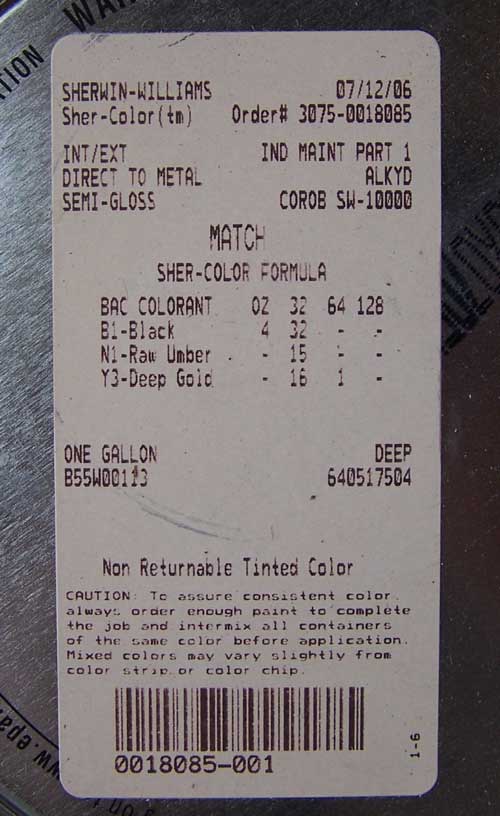

Eric Tuck: I had a paint match done on my Walker-Turner S975 Shaper at Sherwin Williams. I used their Direct To Metal Alkyd Enamel rather than the Industrial Latex because I wanted semi-gloss. The formula is:
WTPaint
