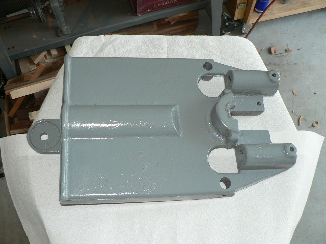

The Parks 95 12" planer, as described on other pages within this wiki, is a well-respected vintage planer, manufactured across several decades by Parks Woodworking Machine Company, with a fairly consistent design throughout its history. This page provides an index of parts for a Parks Model 95 planer, including photographs and dimensions where available.
The original entry data and photographs are drawn from a restoration of machine #5401-, which is believed to have been manufactured in the early 1940s. The parts numbers are mapped to the exploded parts diagram and parts list from the

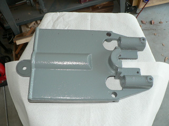

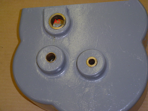

A1 | Gear Box (Casting Only) | - | 1 | "Three hump" cast iron model |

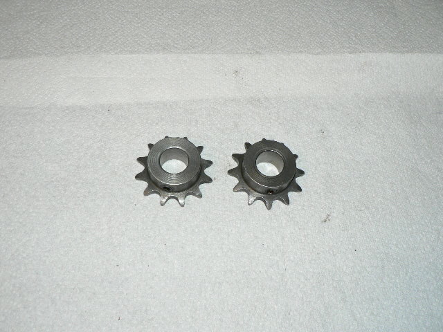

A4 | 12 Tooth Sprocket | .75"ID, 1.375"OD | 2 | 2.25" exterior sprocket diameter |

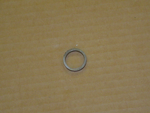

A5 | Shaft Spacer | 0.18" wide | 1 | |

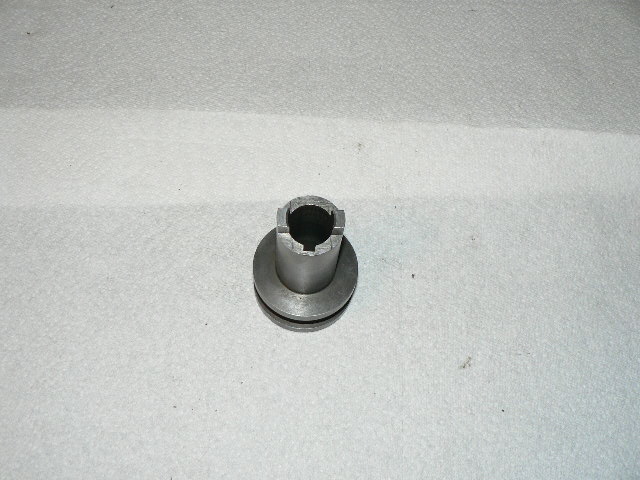

A8 | Throw Out Sleeve | .75"ID, 1.125"OD | 1 | Sheeve: 1 5/32" inner diameter, 2" outer diameter |

A13-20 | Lower Gear Shaft Bearing | .75"ID | 1 | part of gear shaft assembly |
A13 | Lower Gear Shaft Bearing | - | |
A14 | 88 Tooth Gear, Plain Hub | .75"ID | 1 | |
A15 | Short Gear Shaft | .50"OD and .75"OD | 1 | early style |
A15 | Short Gear Shaft | - | 1 | later style |

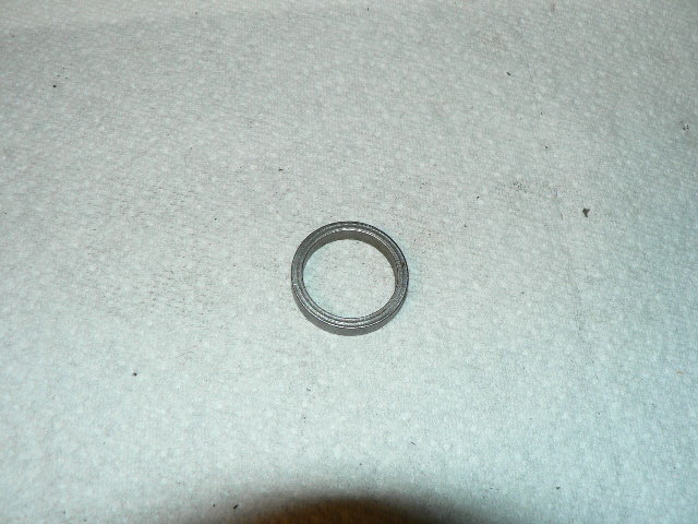

A16 | Gear Shaft Bearing | .50"ID | 1 | |
A17 | 20 Tooth Gear | 1.0"OD, .50"ID | 3 | 1.375" external tooth diameter |
A18 | Gear Shaft Bearing | .75"ID | 2 | |

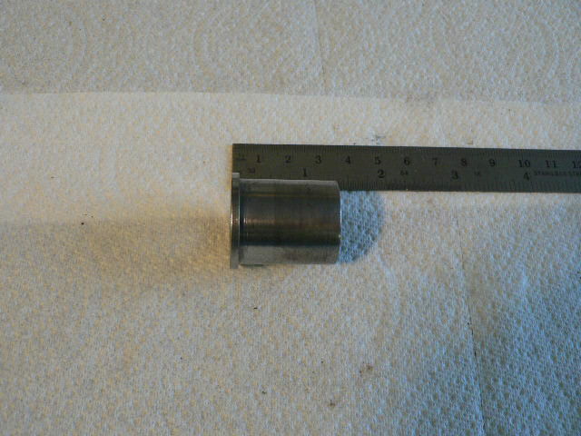

A25 | Head Shaft Sleeve | 1.375" long | 1 | .75"ID, need OD |

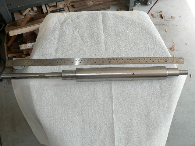

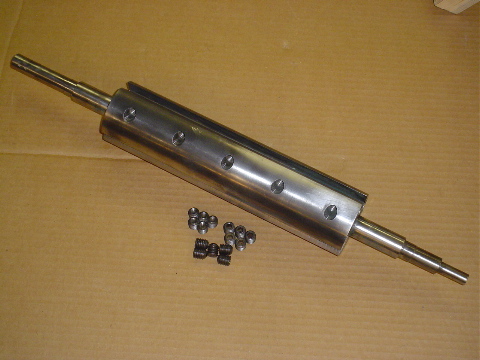

A28 | Head with Shaft | 24" long | 1 | need dimensions of various segments |

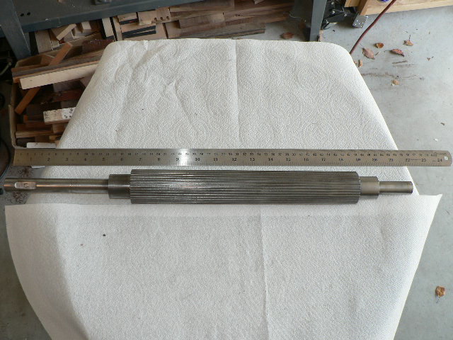

A30 | Fluted Feed Roll | 22" long | 1 | need dimensions of various segments |

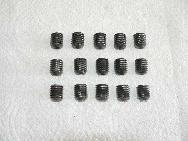

A31 | Hollow Head Set Screw | 1/2" head | 15 | gib screws for cutterhead |

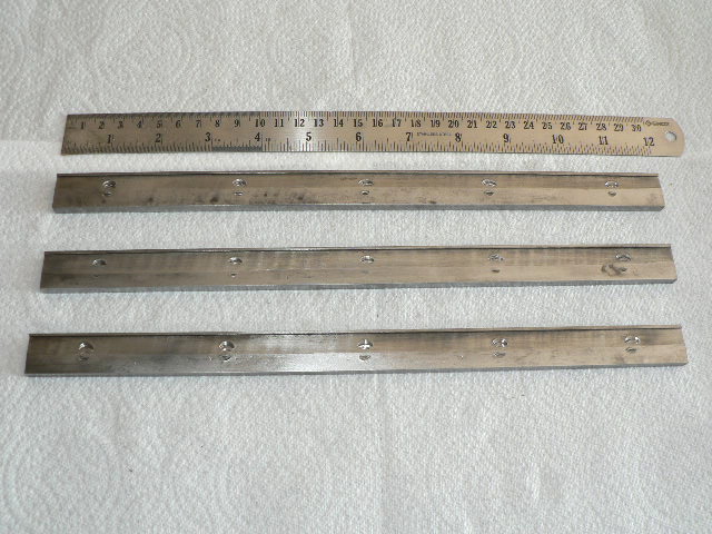

A32 | 12" Chip Breaker | 12" x 3/4" x 1/4" | 3 | |
A33 | 12" HSS Knives | 12" x 7/8" x 1/8" | 3 | someone please confirm |

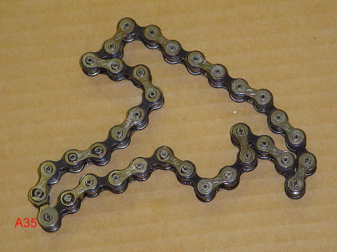

A34 | Complete Roller Chain | - | 1 | |
A35 | Connecting Link for Chain | - | 1 | |

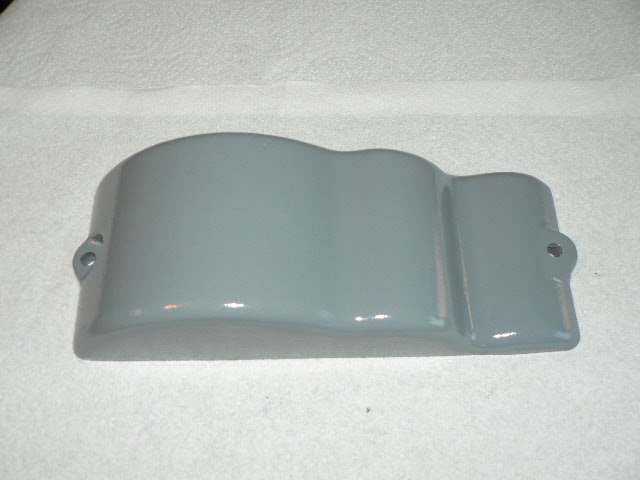

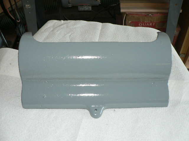

A38 | Shaving Hood | - | 1 | View of Top |
A38 | Shaving Hood | - | 1 | View of Bottom |

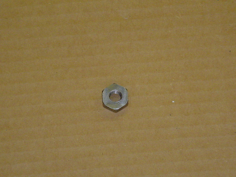

A39 | Lock Nut for Hood | - | 1 | |

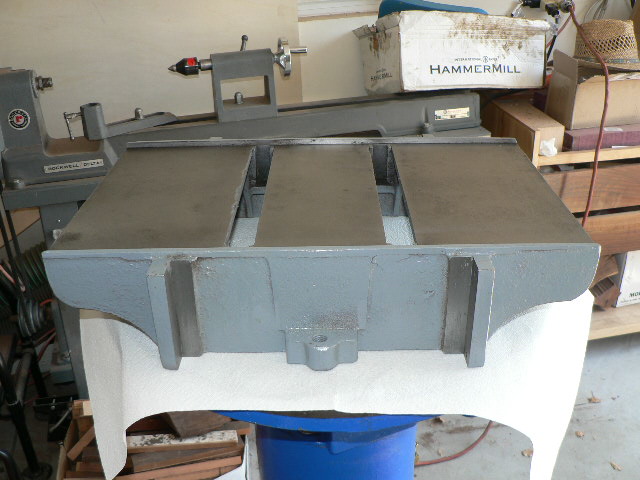

A43 | Table | - | 1 | |

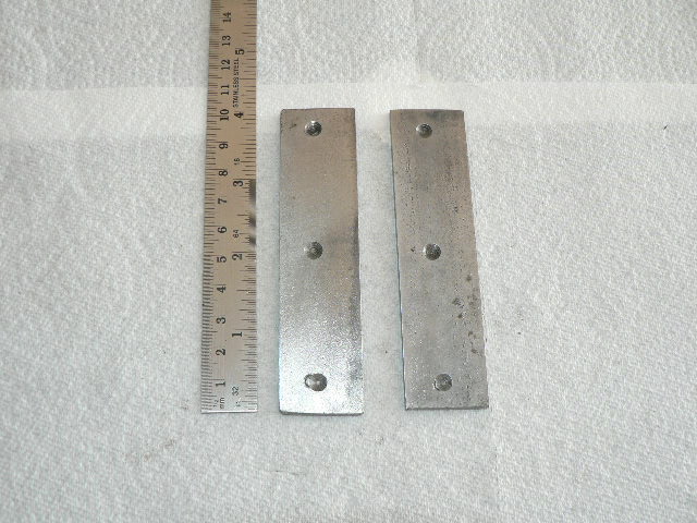

A44 | Table Gib | 4" x 1" x .125" | 2 | |

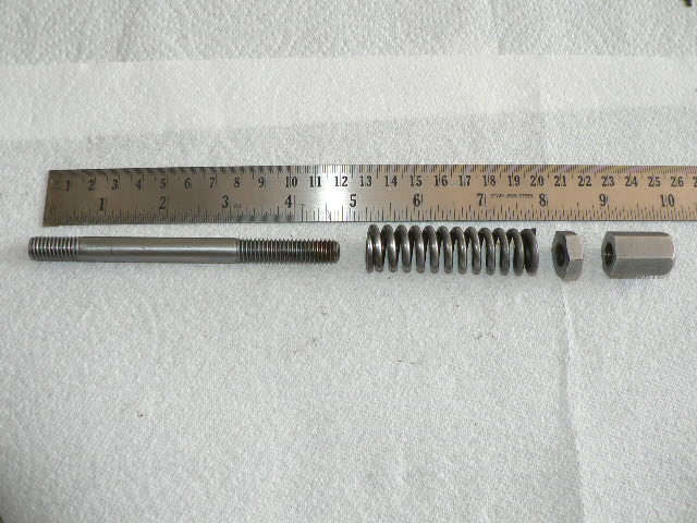

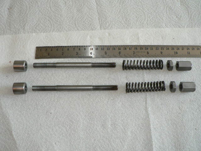

A49 | 3/8" Hex Nut 1" Long | 1" | 6 | part of roller bearing stud assembly |
A50 | Spring Collar | - | 6 | |
A51 | Compression Spring | - | 6 | |
A52 | Roll Bearing Stud | - | 4 | part of roller bearing stud assembly |

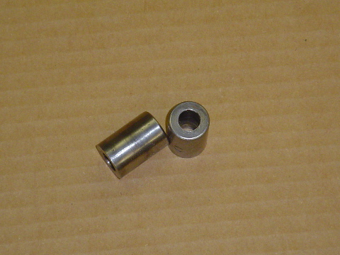

A57 | Bearing Cap Stud | 1" | 2 | 5/16 18 threads |
A58 | Bearing Cap | - | 2 | specify left or right |
A59 | Left Side Casting | - | - | |
A60 | Right Side Casting | - | 1 | |

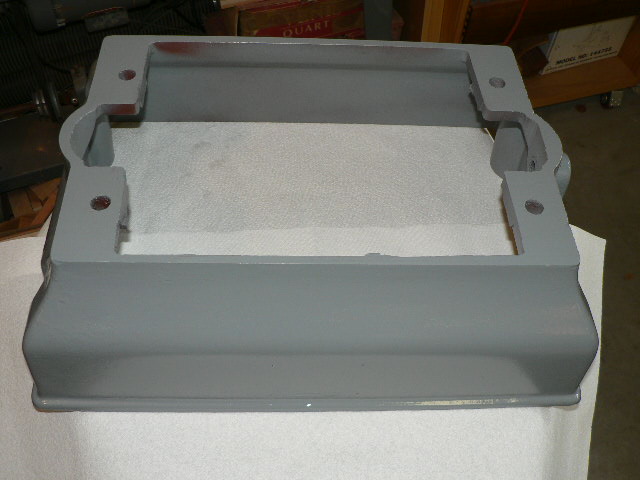

A61 | Base | 19.5" x 14.5" | 1 | aluminum version, style #3 |

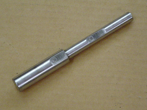

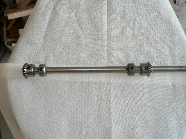

A62 | Elevating Shaft | 20" long, .625" shaft | 1 | |
A63 | Shaft Collar | 5/8"ID | 4 | |
A64 | Bevel Gear L102 | - | 4 | |

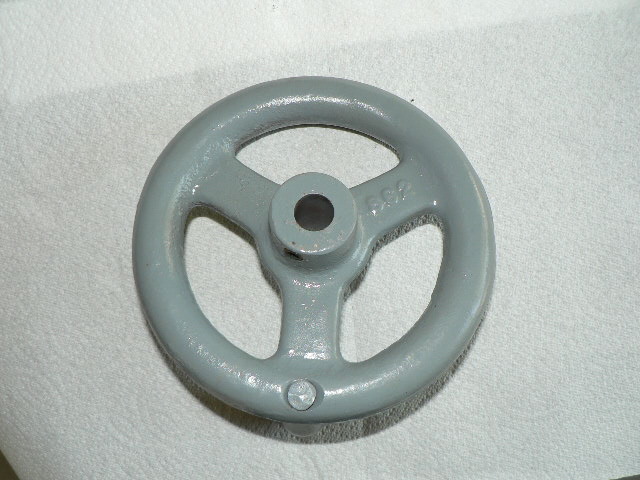

A67 | Hand Wheel and Handle | .625"ID | 1 | Top View |
A67 | Hand Wheel and Handle | .625"ID | 1 | Bottom View |

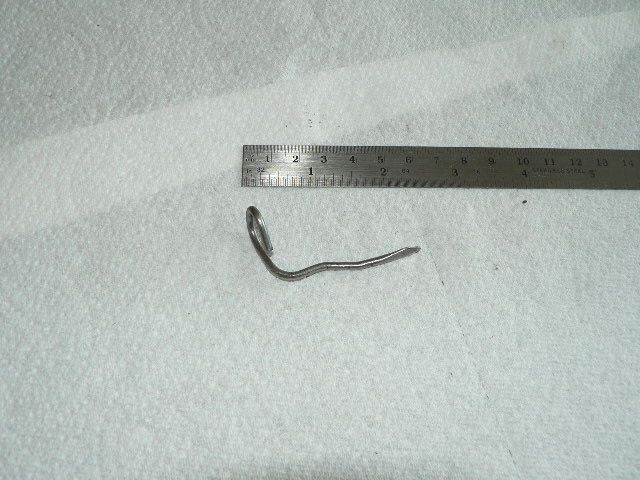

A68 | Depth Indicator | - | 1 | bent wire style |

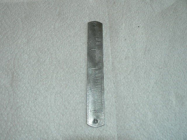

A69 | Depth Scale | 4" scale | 1 | |

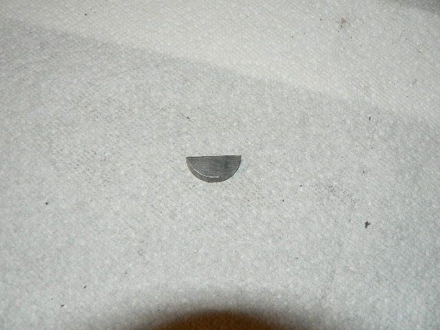

A71 | Half Moon Key | - | 1 | for smooth feed roll shaft, under throw out sleeve |

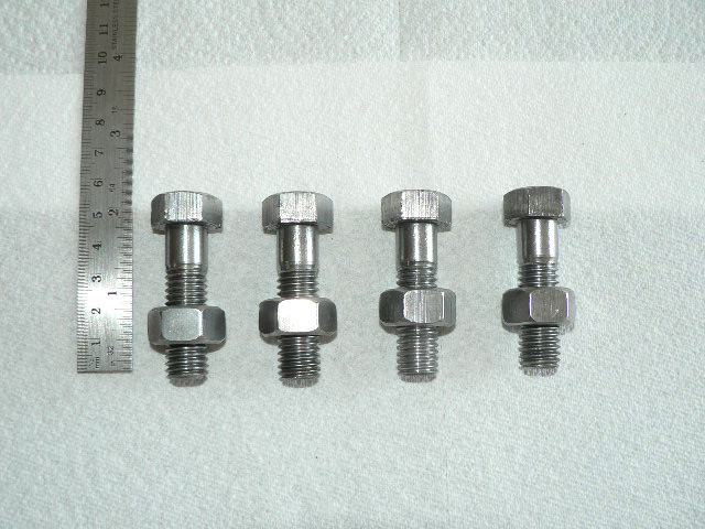

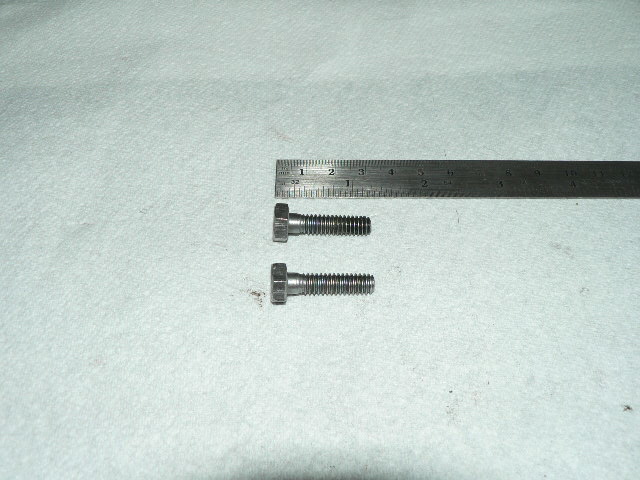

A75 | Hex Head Bolts | 1.75" | 4 | 1/2 13 threads, for side casting mount on base |
A76 | Hex Nuts 1/2"x5/16"x7/8" | - | 1 | 1/2 13 threads, for side casting mount on base |

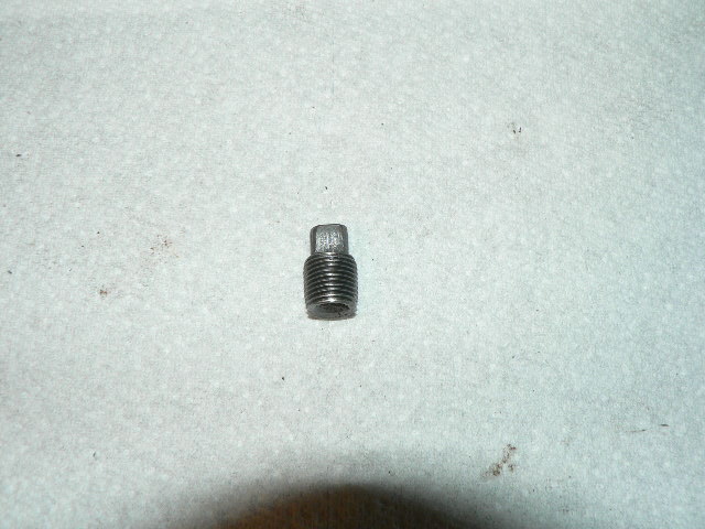

na | Drain Plug | - | 1 | |
