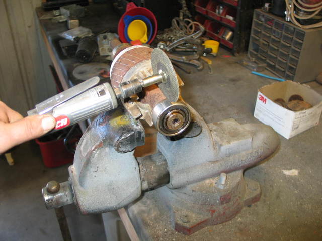

I've seen many posts with people struggling to remove bearings. Broken pullers and propane torches and the like. I've been using this method for approx. 15 years in the Heavy Duty transmission business, and it works 95% of the time, especially on small (under 2" I.D.) bearings.
First, you are going to totally ruin the bearing, so write down the numbers, and take measurements, and so on.
Cut through outer race with a cutoff wheel, or cutting tip on torch.
Rotate the bearing 180 degrees and cut through the other side too, and both halves will fall off. Now split the cage and it along with the balls will fall off. and you will be left with only the inner race.
