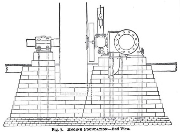

      Fig. 7 shows a form of foundation which differs from the first described by a brace being run across, combining the outboard pillow block part with the main body of the foundation, and the bolts being masoned into the brickwork, the foot ends passing through a broad washer. This foundation is generally used for tangeye bed engines, which usually run at medium speed. The foundation used for high speed self-contained engines is shown in Fig. 8; it simply consists of a solid body of brick-work.
Note.—Foundation bolts should be held in position by a wooden template with bolt holes corresponding to those in the engine base. It is better not to build the foundation solidly around the bolts, except at the extreme bottom. Space should be left around each bolt, increasing toward the top, so that at its upper end the bolt has a play of one or two inches.

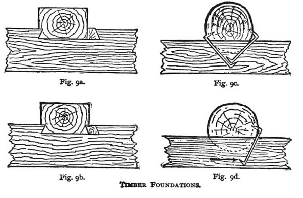

      It is very often the case that a timber foundation is found to be the best, or indeed, the only practicable foundation for an engine or for a heavy machine. The number of semi-portable steam engines used to run dynamos during engineering work of more or less duration, makes it desirable to have a method of holding the machine down, which will permit of "pulling up stakes" on short notice and settling again promptly at a greater or less distance. In such cases, heavy beams may be used for bed timbers, and to these the engine held down by bolts, or, indeed, by long lag screws; in all cases the thread and bearing surfaces of heads, washers, etc., being smeared with grease and graphite (black lead) before running up.
 Timber Foundations
Timber Foundations
      The lengthwise timbers to which the engine is bolted may very easily be secured to heavy cross timbers (to give both weight and lateral rigidity) by dovetail wedges of yellow pine, as shown in Figs. 9a and 9b. In Fig. 9a only one edge of the lengthwise balk is dovetailed, and the wedges alone the other side have one flat bearing side.
      In Fig. 9b both sides of the lengthwise timbers are dovetailed, and the wedges are cut to correspond. Where the wedges have one vertical face in contact with the lengthwise beam, as in Fig. 9a, they should have more vertical bearing surface, as there indicated.
      Such a frame may be locked together in short order, and dismantled quickly and without injury to the timbers. When in service it may be weighted down by rocks or odd castings, or similarly wedged to lengthwise timbers parallel to those on which the engine rests.
      Timber foundations may also be fastened together by dogs of this outline:

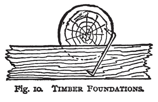

      This mode is not so bad where round logs are used for the heavy cross-pieces; but when dogs are used care should be taken that they always run obliquely across the intersection of two timbers and never parallel with either of those which they join. This applies the “diagonal brace” principle. If this is neglected the structure, if the under timbers are round and lie crosswise of the cylinder-bore, will very promptly work itself to pieces; and in any case, for every dog that leans in one direction there must be another which leans in the opposite direction.
 Timber Foundations
Timber Foundations
      The reason for this is seen in Figs. 9d and 10. The dog shown in Fig. 10 does not properly resist & lengthwise thrust from right to left, as shown by the arrow in Fig. 9d. Where, however, as shown in Fig. 9c, each dog has another one opposed to it, the hinge business is effectually done away with. dogs are only desirable where round timbers are used, as these afford less wedging surface than square ones.
