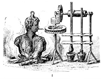

Hero's Aeolipile
      The first recorded instrument for illustrating the power of steam was that described by Hero of Alexandria in his Pneumatic a about 120 B. C, though there is nothing in the text to indicate that it was his invention.
Hero’s Aeoipile
Hero’s Aeoipile
      It was named the " Aeolipile" (Fig. 1), and consisted of a boiler partly filled with water and placed over a fire. Over the boiler there was pivoted on two bent tubes a spherical vessel ("steam-turbine") which was supplied with steam through one of the pivots from the boiler below. Projecting from the sphere in a direction perpendicular to the axis of rotation were two bent pipes, through which the steam escaping into the air exerted a force in a contrary direction, after the manner of Barker's mill, thus causing the sphere to revolve. It is not known that the Aeolipile was ever more than an amusing toy, though some have supposed that it was applied by the Greek priests for producing motion of apparatus in their temples.

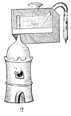

De Cans's Steam-fountain
      Salomon de Caus (1611) was employed by the prince of Wales to decorate his gardens at Richmond in Surrey. He clearly understood the action of the "air" in "Hero's fountain," and improved the machine by the insertion of valves to prevent the return of the water which had been elevated, though he did not observe that it was the expansion and condensation of the vapor in the air that mainly produced the effects in the Egyptian machine and in his own. Had De Caus made a coal fire under his improved fountain, he would have had a good steam-engine. In 1615 he suggested forcing water by a steam-fountain from a vessel by the expansion of steam within the same.
De Caus’s Steam Apparatus
In Figure 3, taken from a drawing probably made by De Caus's own hand, (A) is a spherical boiler containing water, (B) is the cock at the extremity of the pipe which takes water from the bottom of the vessel boiler at (C), and (D) is the cock through which the boiler is filled. The elastic force of the steam formed in the boiler by the application of fire drives the water out through the vertical pipe.

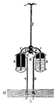

Worcester's Steam-engine
Worcester’s Steam Engine
      Tradition relates that the marquis of Worcester had the first glimpse of his steam-engine when he was a prisoner in the Tower of London in 1655. The marquis wrote (about 1659) his celebrated manuscript entitled "A centurie of the names and scantlings of such inventions as att present I can call to mynde to have tryed and perfected." The sixty-eighth scantling of this manuscript announces the great invention, which has popularized and preserved the fame of this wonderful inventor in the public mind. He calls it "An admirable and most forcible way to drive up water by fire," etc. Worcester's ninety-ninth scantling can be explained only by the use of a piston in a cylinder with water under it. In 1663, Worcester, in his Century of Inventions, describes an engine no drawings of which are extant, but which his biographer, Dircks, has suggested was like the sketch shown in Figure 5. Two vessels (A, A) are connected by a steam-pipe B, B) with the boiler (C), which is placed behind them. (D) is the furnace. A vertical water-pipe (E) is connected with the cold-water vessels (A, A), by the pipes (F, F), which reach nearly to the bottom. Water is supplied by the pipes (G, G), containing valves (a, a), and dipping into the well (H). Steam being admitted from the boiler to each vessel (A, A) alternately, is there condensed, and the vacuum formed permits the pressure of the atmosphere to force the water from the well through the pipes (G, G). While one is being filled, the steam is forcing the water from the other up the discharge-pipe (E). As soon as one is emptied the steam is shut off and turned into the other, and the condensed steam remaining in the vessel permits it to fill again. Worcester's apparatus was not an engine in the proper sense, but a water-raising machine. One of Worcester's engines of about two horsepower was in use at Vauxhall in 1656, but the hopes of its inventor were not realized, as it never became a commercial success.

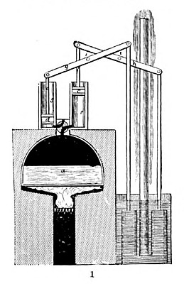

Newcomeri's Steam-engine
Newcomen’s Steam Engine
      It was reserved for the Englishmen Thomas Newcomen and his assistant Cawley to make a practical application of Papin's plan of using steam, which was effected in 1705 by connecting with a steam-boiler a cylinder containing a piston. It was a steam-engine, but employed the pressure of the atmosphere to move the piston and to do the work, and hence was called an "atmospheric steam-engine," which proved to be well adapted for working the main rods of pumps in mines, and, later on, for driving revolving shafts. Figure 8 represents a Newcomen machine in its higher form of development. Immediately upon the dome-shaped boiler, half sunk in a brick furnace, is seen the cylinder with its movable piston. A chain fastened to the piston is placed over a segment attached to a wooden double-armed lever or "beam." This beam at its centre swung upon a pivot, and was united with a connecting-rod, a crank, and a revolving shaft provided with a fly-wheel; and suspended to it were two rods properly secured by chains to two segments. The cylinder, being entirely open on top, allowed the atmospheric pressure to act upon the piston and to set it in motion, together with the described mechanism, when a vacuum was formed in the lower space by the condensation of the steam admitted into it. It is, therefore, worthy of notice that the actual motive-power was not steam, but atmospheric pressure left free to act by the condensation of steam. The use of the chain referred to, did not even allow of the direct action of the steam. This machine took twenty pounds of coal per horse-power per hour.
      In the first machines the condensation of the steam was effected by simply throwing cold water in a shower over the outside of the cylinder. In an improved form of construction it was effected by injecting into the cylinder a jet of water taken from a reservoir, shown on top of the Figure, and kept constantly filled by the machine itself. This improvement was suggested by an accident: "As they were at first working, they were surprised to see the engine go several strokes, and very quick together, when, after a search, they found a hole in the piston, which let the cold water in, condensing the steam in the inside of the cylinder." The alternate admission and exclusion of steam, originally effected by a workman opening and closing a cock with his hand, were here effected by a mechanism connected with a vertical rod, seen in the illustration in front. The valve-gear was first made to work thus automatically in 1713 by a boy, Humphrey Potter, who caused the beam itself to open and close the valves by means of suitable catches and strings; but in 1718, Henry Beighton substituted for the latter a plug-rod, which worked the valves by means of tappets. Smeaton improved this type, in 1774, by oakum cylinder-packing, and by raising the water used for condensation by a pump worked from the main beam; he also covered the lower side of the piston with wooden plank, to reduce unnecessary and untimely cylinder-condensation.

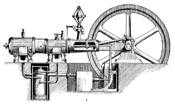

      Having considered the steam-engine from an historical standpoint, with reference both to its design and construction, we shall now consider it from a more strictly technical standpoint. We shall minutely define and scientifically describe it, and shall then give those details which would be out of place in a chronological narrative of its development and growth.
Definition
      A steam-engine is a machine by which the pressure of steam, due to its temperature, may be utilized in mechanical work. The term steam-engine is usually restricted to a motor in which a shaft is rotated directly or indirectly by the pressure of steam upon an alternating or a rotating piston fitting steam-tight, with as little friction as possible, in a cylindrical (or approximately cylindrical) case. A steam engine may be employed to drive a line of shafting, to run one or more machines connected to its main shaft, to actuate a pump or a blower having its piston attached to its piston-rod, to propel a boat in which it is placed, or to move a vehicle on which it is mounted.

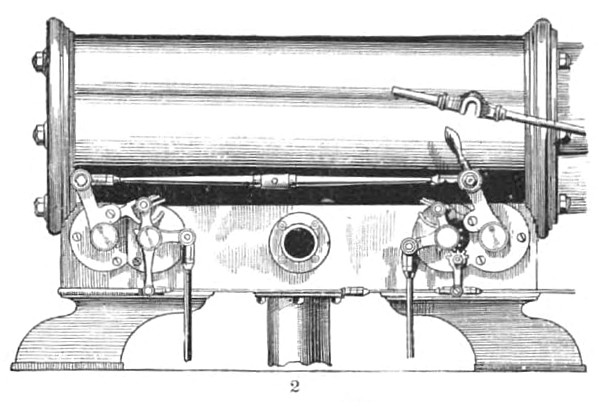

Meyer's Variable Cut-off Slide-valve
Meyer’s Variable Cut-Off Slide Valve
      Figure 2 shows a variable cut-off valve-motion (Meyer's); the upper valve is moved by an eccentric-rod, but it is placed directly upon the back of a three-port slide-valve, also operated by an eccentric-rod. The time at which live steam is cut off by the upper valve (earlier or later according as the load on the engine is light or heavy) is varied by moving the two parts of the upper valve farther apart or closer together by a right- and a left-hand screw operated by hand as may be desired by the engineer. A throttling governor might be used with this movement to make the engine automatic under varying loads and pressures; but the Meyer valve is usually employed where there are no sudden changes either in load or in pressure.

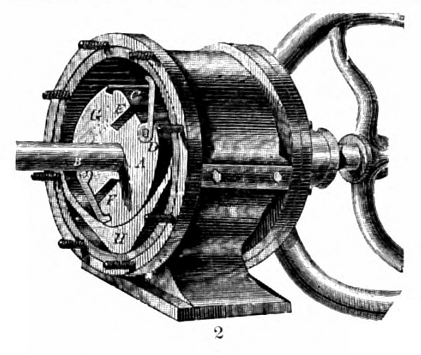

Gonzenbach Valve
Gonzenbach Valve
Gonzenbach Valve
      Figure 4 shows the Gonzenbach valve. The ordinary three-ported slide (A) gets its reciprocating motion on the valveseat (B) through an eccentric-rod which puts first one and then the other of the end-ports in communication with the steam in the steam-chest, while the third port is placed in communication with the exhaust opening through which the steam passes into the air or into a condenser. The upper valve (E), which is in a separate steam-chest (C) and is also moved by an eccentric-rod, permits "live" steam from the boiler to go through the orifice (D), but as soon as (D) is closed the steam is worked by expansion only. If the upper valve has constant travel, this type will require a throttling governor to make it automatic under varying loads and pressures, but if the eccentric throw or its position on the shaft is varied by the governor, the whole becomes an automatic cut-off system.

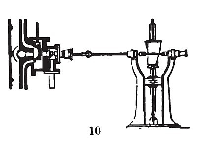

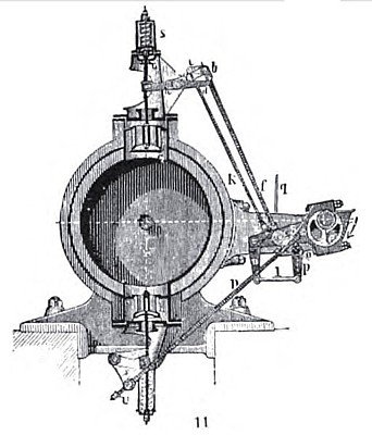

Meyer Throttling Valve with Governor
      Figure 10 represents the Meyer throttling-valve motion, which controls the passage into the steam-chest by a conical valve, whose times of opening and closing are controlled by a stem bearing a yoke operated by a revolving double cam, which is raised and lowered, according to the position of the governor, earlier or later in the stroke.

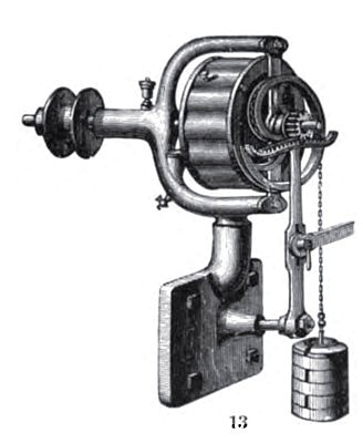

Allen Governor
Allen’s Governor Cross-Section
Allen’s Governor
Allen’s Governor
      Figures 12 and 13 show the Allen governor, in which there is a paddle-wheel in a corrugated cylinder filled with oil (Fig. 13). Increase of engine speed tends to turn the cylinder faster about the wheel, and by means of a segment gear this motion is made to move the cut-off to an earlier point.

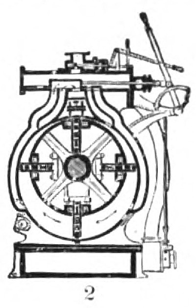

Rotary Engines
 Kenyon's Rotary Engine

      In Figure 1 is shown Runkel's rotary engine, in which a rotating piston or follower is made to turn a crank, thus combining all the disadvantages of both the reciprocating and the rotary type.
 Turner's Rotary Engine
 Borries' Rotary Engine
 Hall's Rotary Engine
 Cox's Rotary Engine
Cox's Rotary Engine
Figure 2 shows Turner's; Figure 3, Cox's; Figure 7, Hall's; and Figure 2, Borries' rotary engines.

      Figure 4 is a good type of the Corliss engine arranged as a " tandem-compound "—that is, with the high- and low-pressure cylinders in the same axial line. In the example given, instead of the admission- and the exhaust-valves of each cylinder being worked from a common "wrist-plate" or disc, as is usual in the Corliss construction, there is in each cylinder one crank-disc to work the two admission-valves and one to work the two exhaust-valves. The two admission-valve discs are connected by a "parallel-rod", as are the two exhaust-valve discs. Each of the four admission-valve cranks is in communication with the regulating device, and also with the vertical rods extending from the dash-pot pistons and with its admission-valve wrist-plate, so that when the governor and its attached regulator-rods disengage the valve-cranks from the control of the wrist-plate rods, the valve is suddenly closed by the action of the dash-pot rod. The wrist-plates of the high-pressure cylinder (the one nearest the crank) are actuated by eccentric-rods from eccentrics on the main shaft, and in turn, by the parallel-rods shown, give motion to the wrist-plates on the low-pressure cylinder.
      A lengthwise central vertical section of a horizontal Corliss engine is shown in Figure 1. Both admission-valves are closed, as is also the left-hand exhaust-valve, the right-hand exhaust-valve being open. Figure 2 shows the "tangent crab-claw" which hangs to the shaded piece shown in the cut, and which is attached to the valve-crank until the action of the governor depresses the entire claw- or thumb-and-finger-like member and allows the vacuum dash-pot piston, which has been drawn up by the crab-claw as the latter opened the admission-valve, to fall suddenly, thus closing the valve and cutting off steam quickly and sharply. The vacuum dash-pot is shown, with a part of its rod, in Figure 3.
