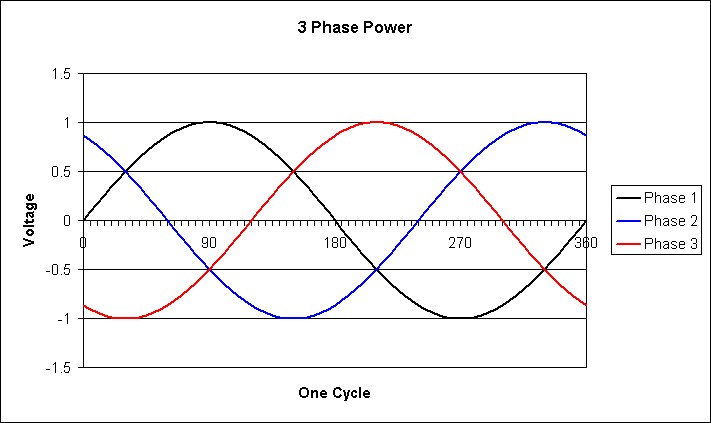

3 - What is 3 phase power and why do manufacturers like it?¶
3 phase power has three "hot" wires, each 120 degrees out of phase with the others. In North America, the standard electrical frequency is 60Hz or 60 cycles per second. In Europe, 50Hz power is more common. Shown below is a representation of 1 cycle showing the three phases.
See the
3 Phase Power Resource Site for more information.
The best simple description I've found is at
Homedoctor.net. It goes like this: 110 / 220 volt single phase current is like a big strong guy driving a tent stake himself. At some point, the work is beyond what that one guy can do. 3 phase is like having 3 guys each striking the stake in rhythm. Each guy is not doing the work of the one big guy, but together, the three of them drive the stake in faster. The total amount of work being done is much greater when added up. Looking at the graphic you can see that one of the three phases is always nearing its peak, thereby generating more consistent power from the motor.
3 phase use allows typically smaller wiring, the motor may last longer and a lighter motor often will outperform a single phase motor using less energy. 3 phase motors also lend themselves to reverse and variable speed operation.
