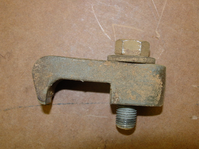

I removed the tilt trunnion bracket and the entire guts came free just like I knew something.
This is the piece.

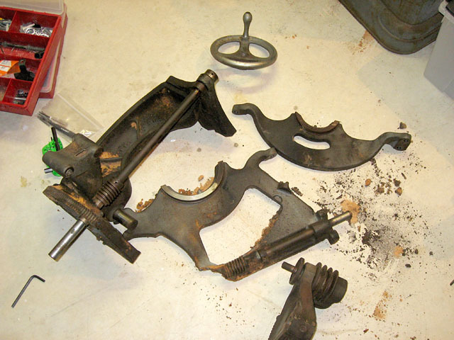

bhaydama tore his Unisaw down and shared the process and some pictures here http://owwm.org/viewtopic.php?t=26112
I have started the tear-down of the saw, and that is where the good story part comes in. Like an earlier poster, I was able to get the guts out without removing the tilting-shaft and raising shafts first. Here’s the process:
1) Remove all possible parts incl. guide block hand wheels, pointer bracket, arbor bracket, etc.
2) Unbolt the front and rear trunnion brackets and remove the bolts.
3) Lift the guts up tilting up the rear…this is the tricky part. It may not seem like it will work but lift the rear trunnion bracket up as far as it will go, then lightly knock the rear trunnion bracket up and away (towards the back of the machine) until the u-shaped lip disengages the matched groove in the rear trunnion. This won’t happen easily, and you may have to bump the rear trunnion bracket a few times with your fist to get it loose-no need for hammers here, your fist is enough.
4) Once the rear trunnion bracket comes loose from the rear trunnion, you are home free. It is a bit scary when the bracket lets loose. Holding the yoke assembly with one hand, remove the rear trunnion bracket with the other and set it aside (while still holding the yoke). It may be good to have a table or cart nearby. The yoke assembly will want to rotate down and upside down with the front trunnion gears pointed towards the roof – let this happen slowly. Once the yoke assembly is upside down, tilt the back of the assembly toward the floor and slide it back so the raising shaft slides through the cabinet. You can either set the yoke assembly on the floor of the saw or lift it out.
5) Lift out the front trunnion bracket. 6) You’re done. Have a beer and pat yourself on the back.
What good would a story be without pictures?
Serial number and modern inventory sticker - I will remove the sticker.
The inventory tag - this is a keeper!
The guts are out, the tilt raise shafts are still in place.
The guts - close up.
