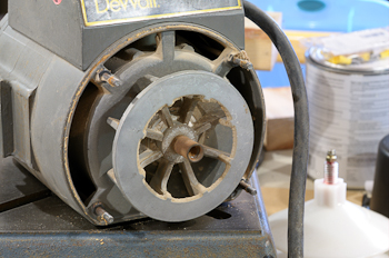

First, remove the acorn nuts with the 5/16" socket. Then remove the fan cover (be careful not to bugger the threads of the tie rods).

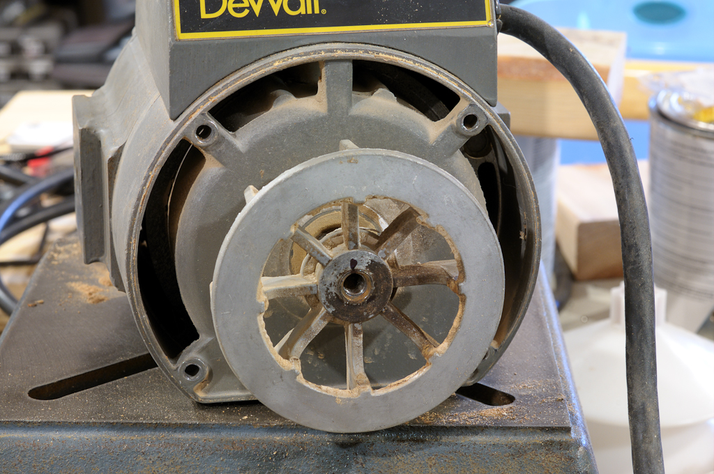

With the cover removed we can see the fan clearly as well as the 5/16" nuts and lock washers holding the rear end bell in place.

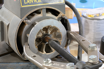

Use a puller to remove the fan. In these pictures you can see quite a bit of rust on the rear arbor and it was a mistake not to remove it first. If the arbor is clean then the fan should be a lot easier to remove. It is extremely important that you keep the fan as symmetrical as possible while pulling it. I can't stress this enough. In this picture you can see that threaded part of the puller is larger than the diameter of the arbor. I used a bolt with the right diameter and pushed on that instead of the arbor to finish the pull.

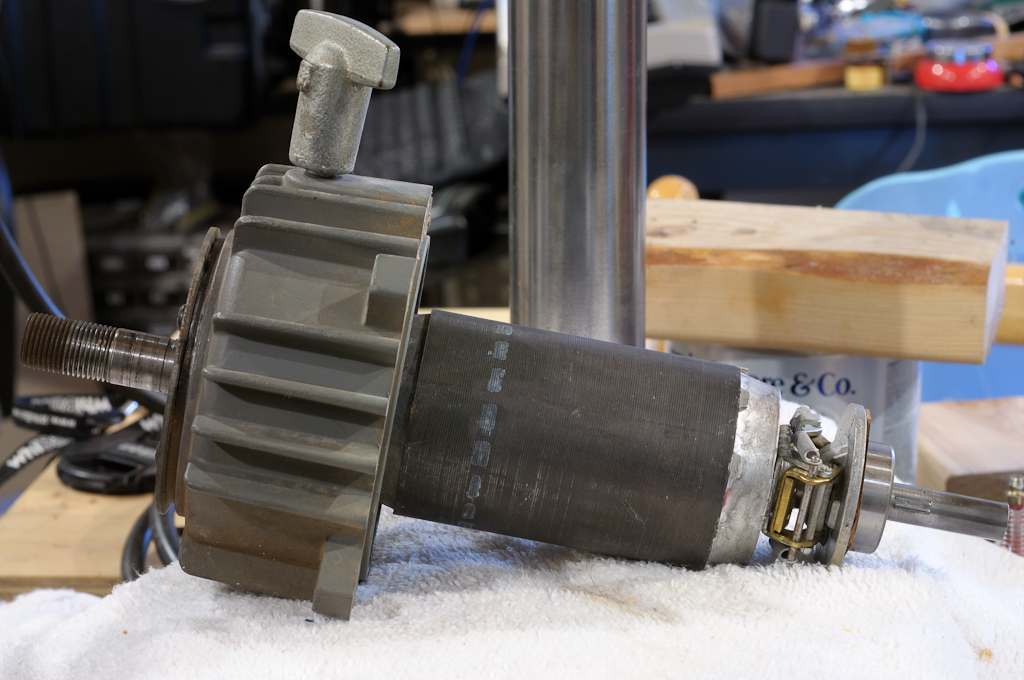

Assuming the fan is balanced you want to take advantage of this fact. Mark the arbor and the fan so you can put it back exactly the way it came off. Once the fan is removed unbolt the nuts and lock washers from the tie rods. Use a soft mallet to tap on the rear arbor and dislodge the rear bearing while pushing the rotor toward the front of the motor.

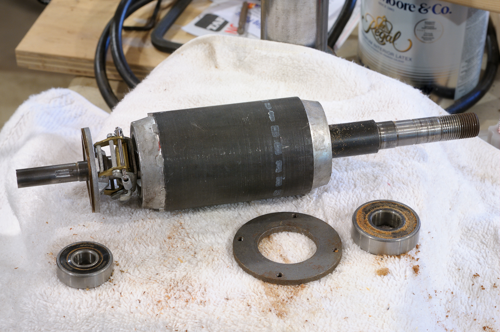

GENTLY remove the rotor assembly front the motor (now is not the time to scrape the windings!) Once removed we can see the rear bearing still on the rotor as well as get a clear view of the centrifugal brake mechanism. IMPORTANT - There is a spring washer in the rear end bell that needs to sit between the bell and the bearing. Make sure you keep track of it for re-assembly. It is critical for a clean fit and quiet motor.

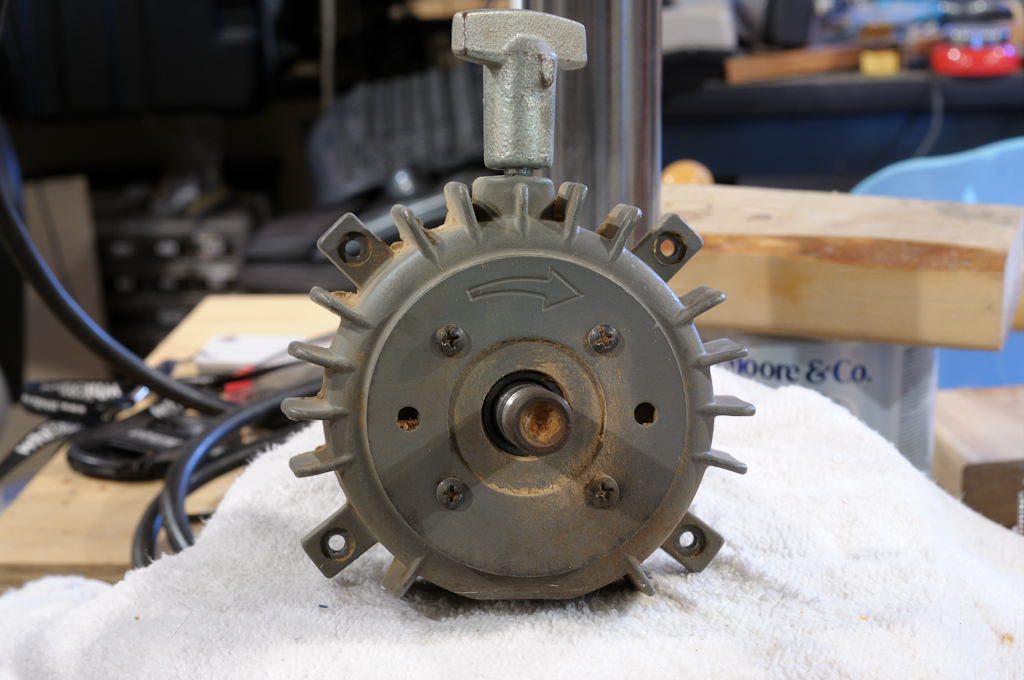

Next we will remove the screws holding the bearing retainers in place. I have read several accounts of folks removing this retainer and then firing up their motor. This will destroy the motor 99% of the time.

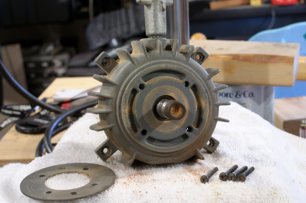

With the screws removed we can set aside the outer retainer and move on to taking the front end bell off.

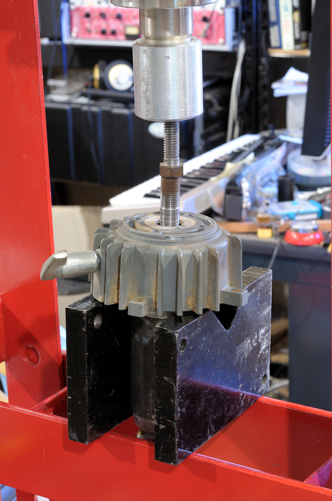

Simply press down on the arbor while making sure the front end bell is sufficiently supported and everything can move freely. Nice and slow... again you can see I used a large bolt to span the space between the press and the arbor. It's good to have an assortment of these handy. The press always seems to be too far or too close to the item needing to be pressed.

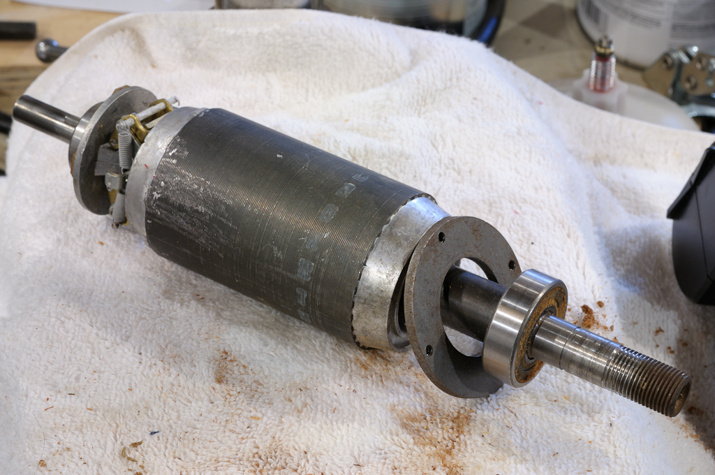

Now the rotor is free and we can see the inner bearing retainer clearly.

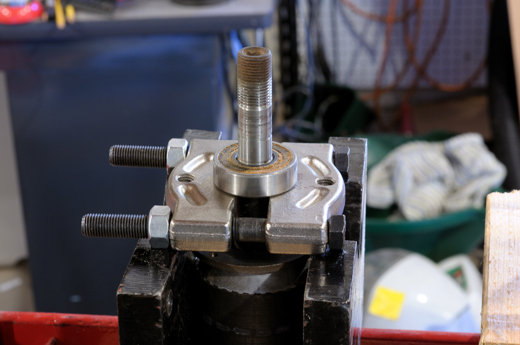

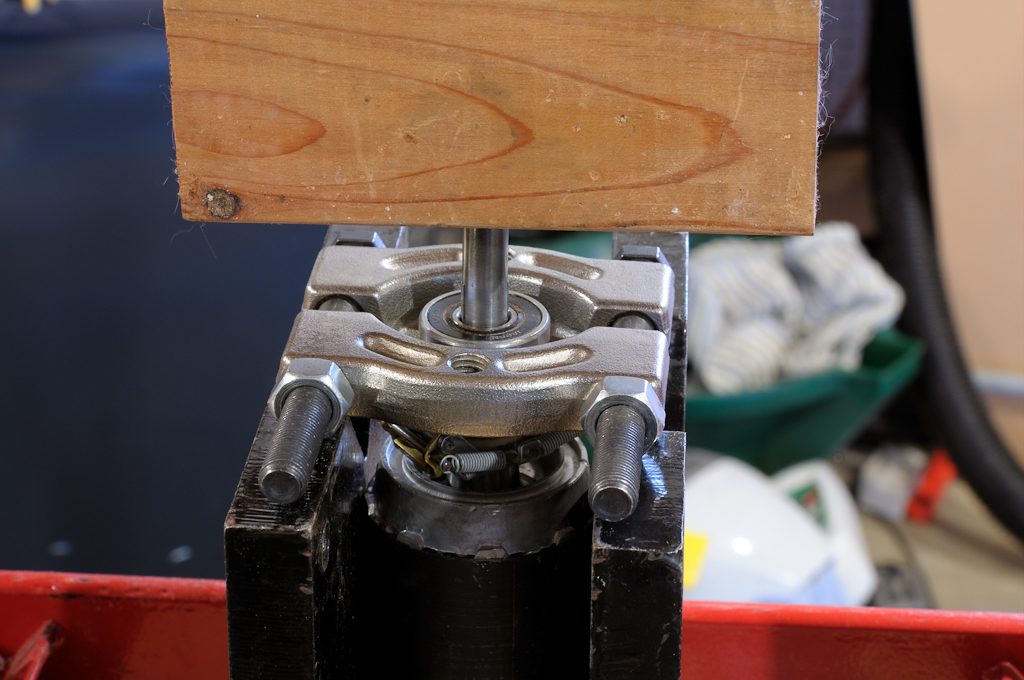

Use the bearing splitter to press the rear bearing off. It is a bit tricky to get in between the brake and the bearing but the OTC 1122 is a very good fit. Again, nice and slow. It really doesn't take that much pressure. It is very important that the splitter not be too tight. It can easily shear off metal if anything binds and you aren't paying close attention (I speak from experience).
Do the same for the front bearing (here the splitter is in the correct orientation because I had enough room).
Everything is all apart. Take care with the brake mechanism. The "pads" usually need to be roughed up slightly with some fine grit (220) sand paper. Just enough to take the glaze off.
