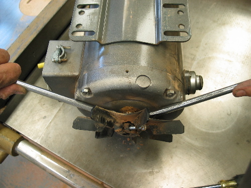

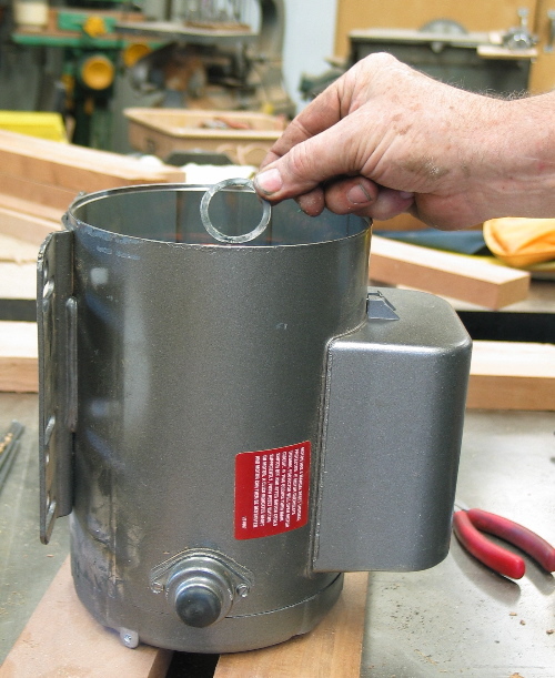

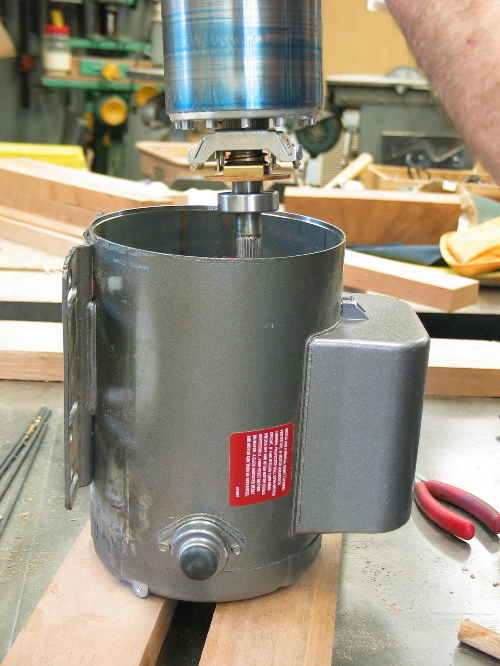

Here's some pics of digging into a Baldor motor to repair a bad centrifugal switch posted by Bob Vaughan {Reference:http://owwm.org/viewtopic.php?t=31506|http://owwm.org/viewtopic.php?t=31506}. In this example, the contacts were damaged and needed repair.

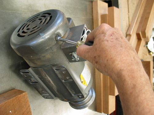

Remove the fan cover

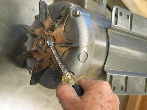

Remove the fan (be careful here)

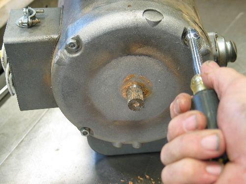

Remove the motor bolts

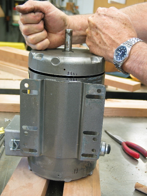

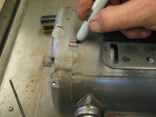

Mark where the end bells line up

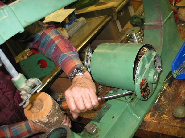

Knock loose the rotor from this direction

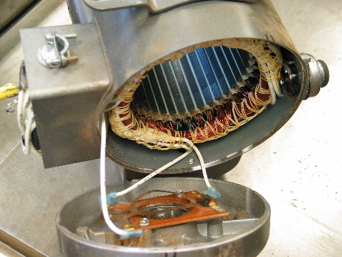

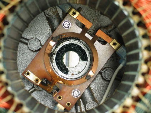

Here's what you should see inside. Note charred contact points

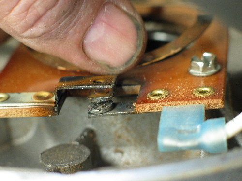

Here's the points that need filing, sanding, and otherwise smoothing out. Be careful not to bend the copper springs.
Set the motor upright on two blocks and insert the spring washer into the bearing housing

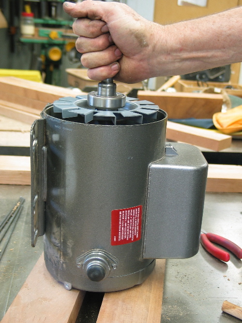

Carefully put the rotor back in

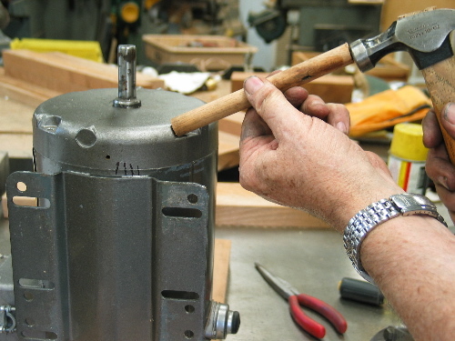

Gentle pounding should seat things
Tap on a stick to rotate end bells for proper alignment and assemble motor
