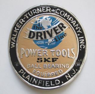

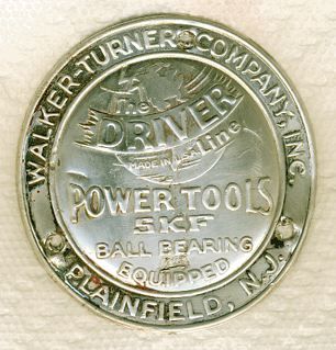

Here is a W-T badge that lost virtually all its original paint when attempting to remove a coat of paint it had received at some point in the past. Though not completely true to the original W-T scheme, it turned out very well, and is quite attractive to boot. This scheme uses more of buff/tan field color instead of the original milky yellow. Spray paint for the outside ring, Testor's Blue, Black, and Sand for the insides. Maybe not like the original, so let's call it "Walker-Turner inspired"!
Cleaned up the finer details with a scalpel. Also took a tip from an auto repair web site for polishing the unpainted high spots. Take some 600 grit or crocus cloth paper and punch out some discs with a paper punch. Glue those on the eraser end of a pencil. Makes a small, flat, and easily controlled sanding disk. {Reference:http://owwm.org/viewtopic.php?t=34169|http://owwm.org/viewtopic.php?t=34169}
Image Image
Note: Oftentimes badges will have one or more coats of paint over top of the original colors, as in the example above. These layers may be carefully removed with carburetor cleaner and a white scotchbrite pad. You have enough control to see when you are dissolving the base color.

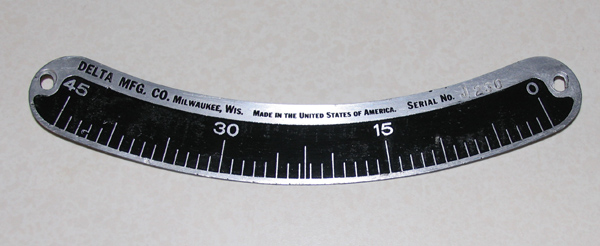

Here is a more complex single color method using maskant that yielded stunning results. {Reference:http://owwm.org/viewtopic.php?t=34288|http://owwm.org/viewtopic.php?t=34288}

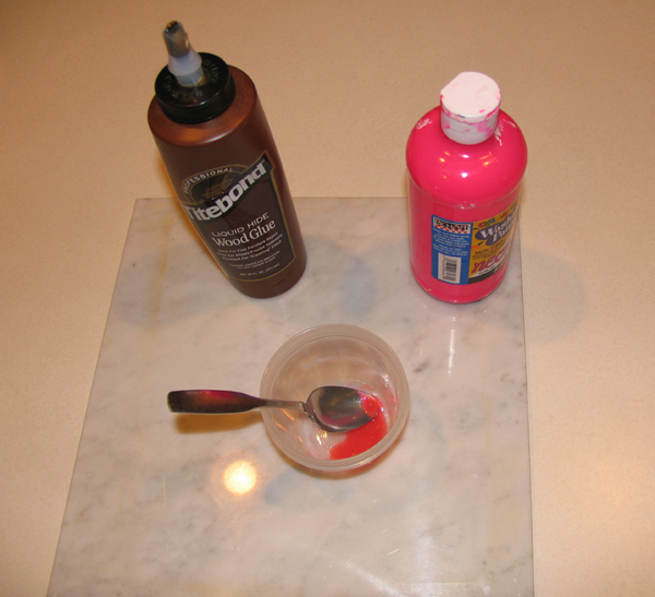

Hide glue was selected as the maskant. Some bright washable poster paint was mixed in to make the glue show up better. make sure you mix in "enough" color.

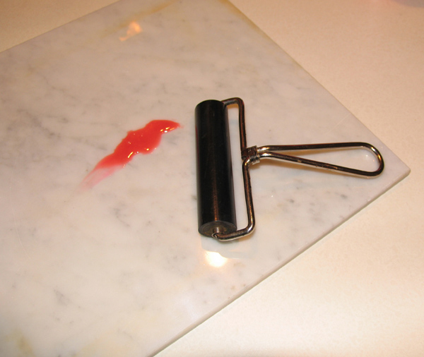

A brayer, which is a small, hard roller used in printmaking, was used to roll a very thin layer of the mixture on a marble tile.
The goal is to roll it until the brayer is coated with a very thin uniform layer of material. It was then rolled across the tag. You may have to add more color to the maskant if it is not readily visible on the tag.
Note that multiple passes will tend to lead to contaminate the areas not to be painted. Since the glue should be thin, it will be easily removed with water (or other appropriate solvent depending on the maskant) until you get the application right.

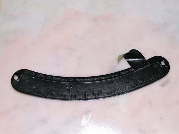

Once the maskant has dried, put a piece of tape over anything that you don't want to paint. Then spray the entire tag. In this picture you can also see the pink layer of glue rolled out on the tile:
Once the paint is dry to the touch, soaked the whole tag in warm water for about 20 minutes and then rub off the masked areas with a damp cloth. Here's the result:
The tag is virtually perfect. The two exceptions are the area on the left that had severe scratches and dent that left a high spot, and a little patch at about 10 degrees where some glue accidentally got in the field. These can be touched up. Overall a very nice result, and the whole process was very quick.
