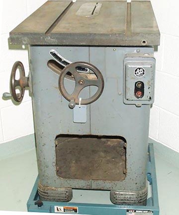

The very first thing you will need to do is, find out the name, rank and serial number of the machine. This will aid you later when questions come up and for finding a manual.
This Unisaw is nearly identical to every Unisaw ever built. A parts drawing for a newer saw was used along with one vintage to the saw during its restoration.

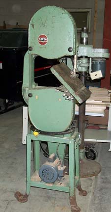

Prior to taking the machine apart, take pictures and/or make sketches. Regardless of whether you have a manual in hand you will use these later when re-assembling the machine. At the very least you'll want these to show to friends and family as a document of what a sad bastard it was and what a glorious machine it became under your watch.
No one would ever believe this saw could have ever been green but people will wonder why after it's done.

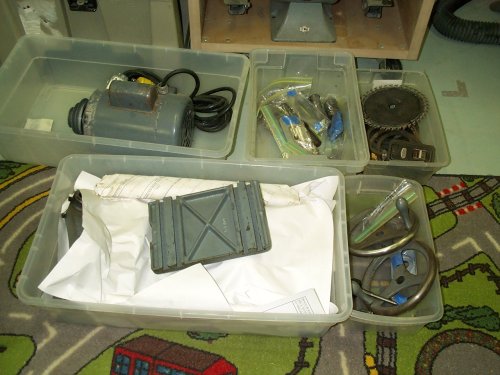

It's probably self evident what we'll be doing with these but I cannot stress enough the importance of cataloging each and every piece removed from the machine. When I'm stripping down a machine I try and keep sub-assemblies together for as long as possible. For instance, the lower base casting for a bandsaw does not need to be fully disassembled. It can be set aside for later disassembly.
Parts here have been bagged, cataloged and placed into plastic tubs to help keep track of them.

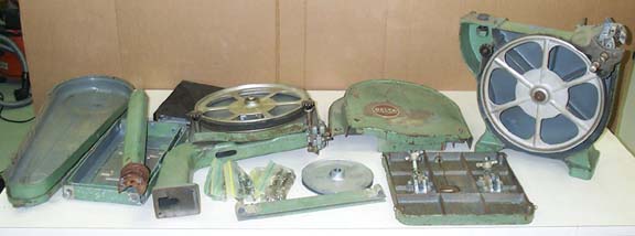

  2. Tear down the machine into manageable components and work from the ground up. This means starting with the stand, working up to the part or assembly that fastens itself to the stand until you've gotten all the way to the table. This method can be tedious but there is a trade off with your sanity. I also favor this for storage reasons. A machine broken down into bite size chunks can be rat holed better.
  3. This involves a mix of both. Consider that you'll probably only want to visit the sand blaster once. It makes sense to get those pieces ready for blasting and get that over with. Cleaning metal parts, priming all the parts and finally painting all the parts at once will save you some time and effort. Personally, I'm in it for the fun so time means little to me.
This saw was taken apart to easily get it into a basement shop. The baggies contain parts for the base.

Set aside the parts after marking them. I find heavy plastic totes good for segregating assemblies and things that need to stay together. The baggies work nicely for nuts, screws and other small parts or for parts you don’t want to become damaged.
I pick up casters whenever I can from garage sales and estate sales. These are then mounted to scraps of plywood. Larger components or tubs are stored on these for easy moving about the shop and rat holing.

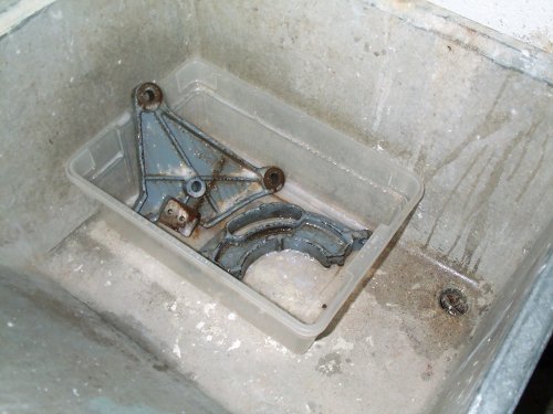

Once you've started freeing up pieces you can get down to cleaning. I use a mix of chemical and abrasives for this task.
I start with a good hot water soaking followed up with a full strength spraying of Castrol Super Clean. I've tried other degreasers and cleaners but nothing has matched the Super Clean. With the Super Clean on the part I go at it with stiff brushes and Scotch Bright pads. This will typically leave you with a part that has dull paint but clean. Cleaning is followed with a good rinsing in hot water and then the part is blow dried with compressed air. I use hot water to promote evaporation. The hotter the better. By the way, wear heavy insulated rubber gloves. The Castrol will leave flesh looking like hamburger and the hot water rinse can get brutal. Any surface rust that creeps in over the next few days can be cleaned off with a maroon Scotch Bright pad.
A couple of parts soaking in Super Clean prior to scrubbing.

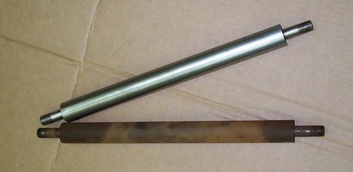

I save using wire wheels for screw threads, removing paint from cast iron or parts that won't be seen. I don't like the finish they leave on bright metal parts. That's just me.

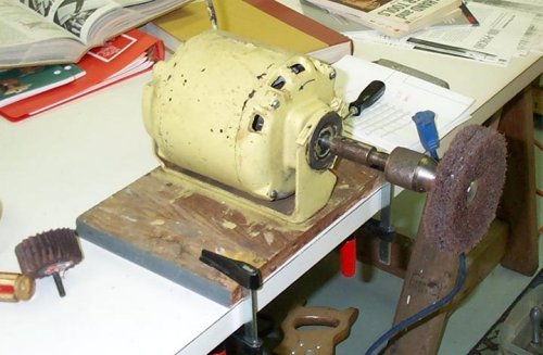

For machined surfaces I will sometimes brighten them up using a Scotch Bright wheel with a 1/4" mandrel. The Scotch Bright isn't so abrasive that you'll take off metal but I do take it easy for critical parts that have to fit within another part.
This Scotch Bright wheel quickly cuts through rust, tarnish and grime. The smaller wheel give a little more polished finish.
A before Scotch Bright and after Scotch Bright picture. Can you tell which is which?

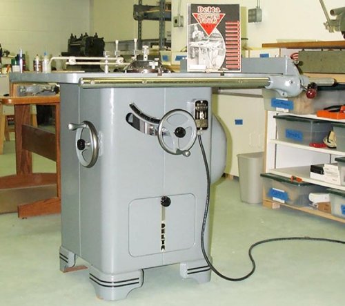

The day has come. All the parts that should be shiny bright are and you can't wait to start putting it all back together. Get out the pictures, sketches and video tapes. Review where you were and get to it.
One thing I do during reassembly is coat all the machined surfaces with a dry lubricant like chain lube with moly. This is less likely to attract and hold dust and dirt. Be sure to lubricate machined surfaces that are joined to other machined surfaces. You can also use a product called Never-Seez for this step. You should also be using Loc-Tite for screws you don't want rattling off later and the Never-Seez for screws you’ll want to become free again.
Reassembly, by the way, is pretty much a reverse of everything you did to get it apart. The only difference is, you're smarter now and you know the proper sequences. You also know the machine intimately and won’t hesitate to make repairs when the are required. Chances are, you’ll also take better care of it. Oh and, congratulations.
This is the same saw shown at the top of this article. The restoration took just over a month of weekends and some week nights. It was time well spent
