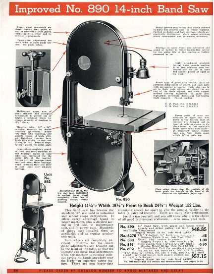

1937 Improved 14" Bandsaw
  • Models: 890- Woodcutting, 880- Metalcutting
  • Wheel Cover Badge: Red circle, three vertical stripes, DELTA angled up from left to right.
  • Serial Number Badge: None
  • Patent Decal: Yes
  • Knobs: Knurled steel
  • Wheel Cover Type: Stamped steel with rounded edges on the face. Lacks the raised rays and hub from the previous version.
  • Color:
  • Wheel Type:
  • Stand Types:
  • Switch Plate:
  • Switch:
  • Motor Options:
  • Belt:
  • Belt Guard: Cast iron belt guard available
  • Blade: 93" standard, 105" with riser block
  • Accessories: 882- lamp, 894- 6" riser block
