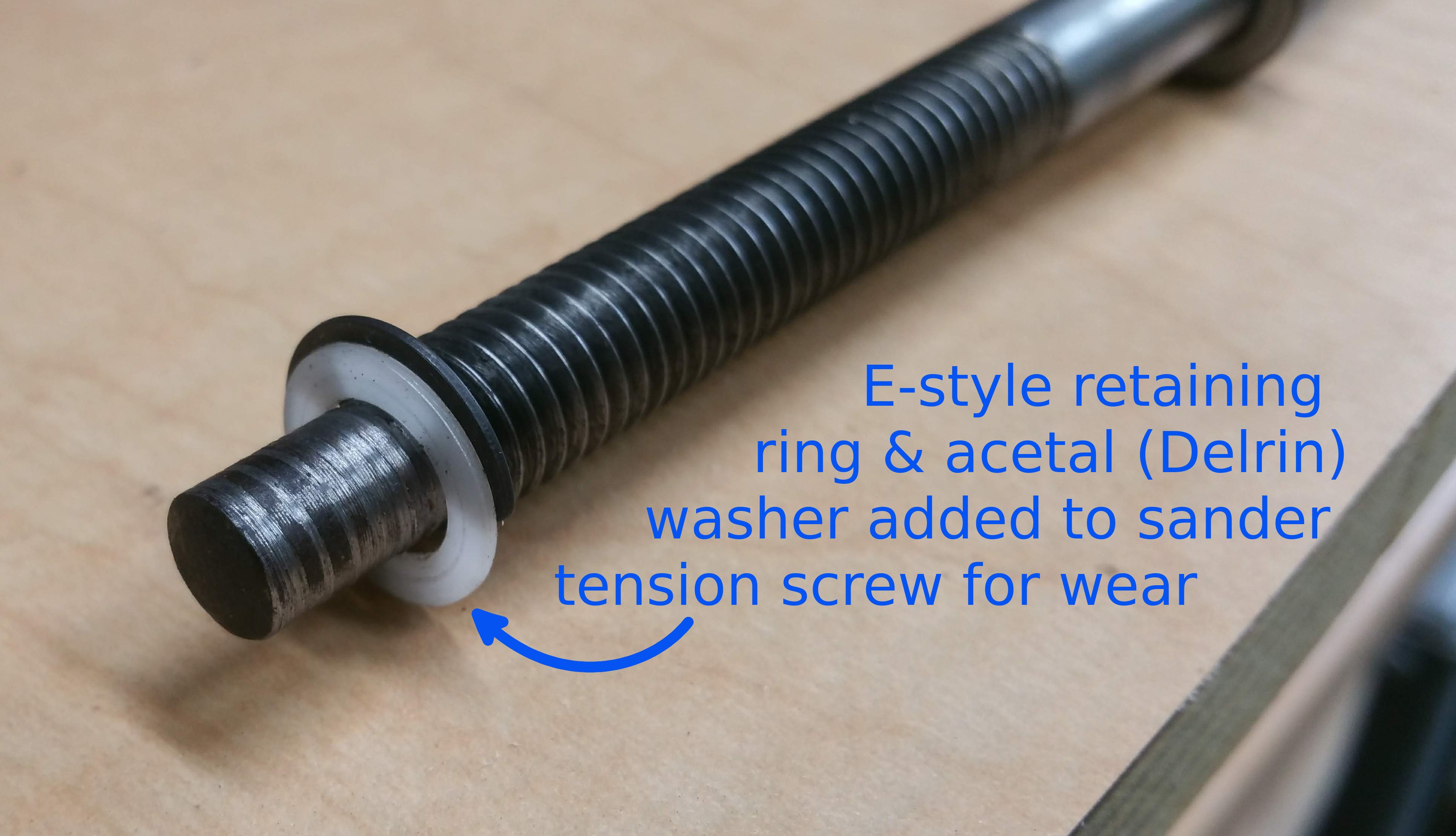

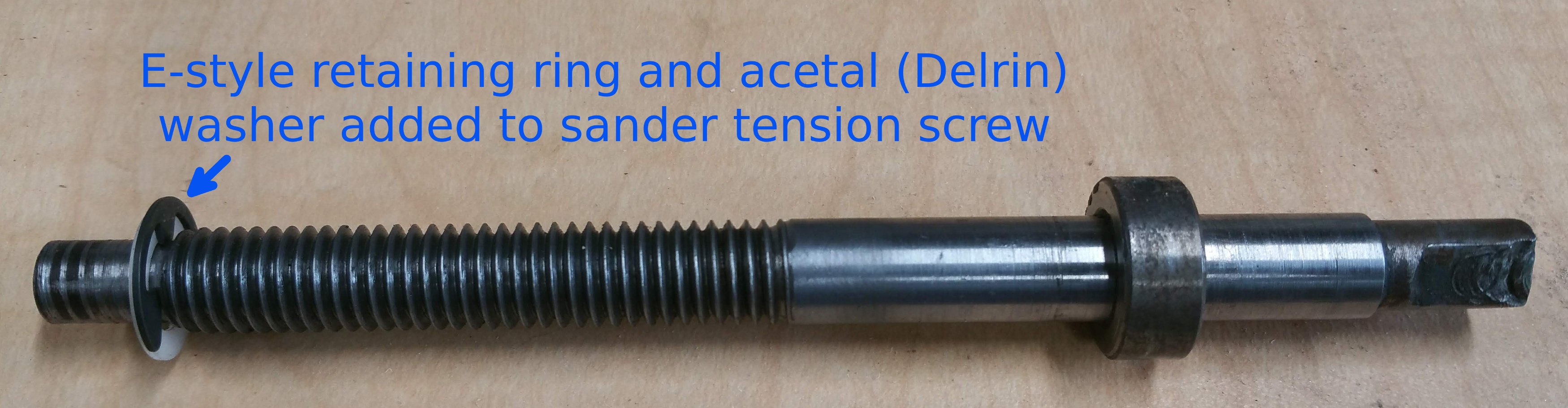

It was my wife's fault: 1952 Delta 6x48 Belt Sander, mostly
This is an alternative to the solution presented below to the problem of the tension screw wearing against the inside of the casting, allowing the end of the tension screw to protrude past the plane of the platen and get in the way of sanding. The idea came from scw1991 from the thread Delta 6x48 31-730 sander repair details(16 pictures)
Tension screw modified to accept an E-style retaining ring & acetal (Delrin) washer to prevent wear of threads on inside of casting
