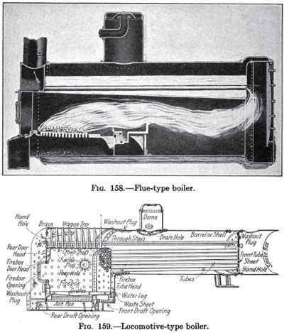

10. Boilers—The boiler of the steam traction engine is internally fired. Some builders utilize the return-flue type (Fig. 158), others the direct-flue or the locomotive type (Fig. 159).

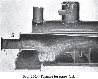

Furnace for Straw Fuel
Coal, straw, wood and crude oil are used as fuels for traction engines. In some states lignite is used. Some builders supply traction engines with attachments for converting them from coal-burners into oil-burners. When using straw for fuel, the furnace is modified as shown in Fig. 160. Slab grates are then substituted for the ordinary coal grates and the straw is fed through a chute S. A hinged trap T is provided to prevent the entrance of air when the straw is not being fed.

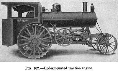

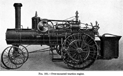

      In some makes of traction engines, the boiler is mounted upon the truck and is used as the foundation for the engine (Fig. 161). Other types (Fig. 162) have the engine mounted under the boiler, the frame supporting both engine and boiler.

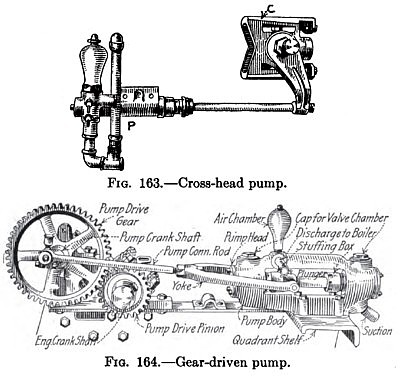

11. Pumps—Three types of feed pumps are used on steam traction engines: the independent pump which is similar to the types illustrated in Chapter III, the cross-head pump P (Fig. 163), which is driven from the engine cross-head C, and the gear-driven pump (Fig. 164). As in the case of stationary engines, two independent methods should be provided for feeding water into a traction engine boiler, using either two pumps or an injector and a pump.

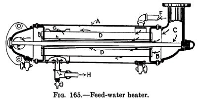

12. Feed-water Heaters—Feed-water heaters are used on some traction engines. The type often employed is illustrated in Fig. 165. The feed water passes around the tubes and the exhaust steam passes through the tubes.

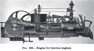

13. Engine Types—The type of engine usually employed is some simple form of steam engine with a slide valve (Fig. 166). Some traction engines have double-cylinder engines.

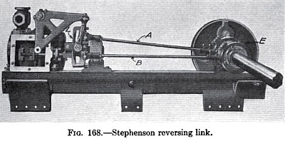

14. Reversing Mechanisms for Steam Traction Engines—A steam traction engine can be reversed either by a Stephenson link similar to that used on locomotives, or by some form of single eccentric radial valve gear.
      To reverse an engine by means of the Stephenson link, it must be provided with two eccentrics, each being connected by an eccentric rod to the end of a link. A block connected to the valve slides along a groove in the link.
 Stephenson Reversing Link
      This type of reversing link as applied to a traction engine is illustrated in Fig. 168. The two eccentrics shown at E are attached to the curved link L by means of the eccentric rods A and B. The position of the link is varied by the reverse lever through the reach rod. In one position of the link the motion to the valve is given by one eccentric, driving the shaft in one direction. This direction of rotation is reversed by raising the link, so that the valve receives motion from the other eccentric. If the reverse lever is moved so that the block is in the middle of the link, the motion given by both eccentrics will be equal and opposite, and the valve will have no motion.

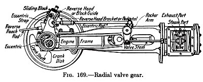

      Most traction engines employ a single-eccentric radial valve gear (Fig. 169). This reversing gear consists of an eccentric fastened on the crankshaft with an eccentric strap which has an extended arm, pivoted in a sliding block. The block slides up and down in a guide and gives motion to the eccentric rod, which is transmitted to the valve through the rocker arm and valve stem. The block guide is hung on a trunnion and it can be tilted in any direction by the reverse lever acting through the reach rod. The angle at which the guide is set determines the direction in which the engine is to run. The reverse quadrant is usually provided with three notches. When the reverse lever is in the central notch, no motion is given by the sliding block to the valve stem. In the position shown, the block sliding up and down in the block guide moves the valve in one direction. Placing the reverse lever in the notch at the extreme right reverses the engine.

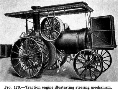

15. Steering—Steering is accomplished by turning the front axle. This is done by chains C (Fig. 170) which wind upon a spool. The spool is operated by hand through a worm W and pinion P (Fig. 170). Another method is to operate a screw by the worm and pinion, the screw moving a nut which is connected by a system of levers to the front axle. Some traction engines employ steering mechanisms similar to those of automobiles. On large traction engines steering is accomplished by power furnished by the engine through a friction disc.

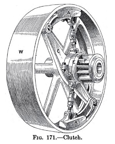

16. Transmission Systems and Differentials—A friction clutch, the function of which is to disengage the engine from the propelling gear, is illustrated in Fig. 171. The flywheel W is fixed to the engine shaft, and, when used as a belt wheel, it is not connected to the arm C, and thus does not transmit motion to the pinion F which is rigidly connected with the arms C. When the clutch is thrown in, pressure is applied at E which rests in a groove in the piece D. This results in B crowding the shoe A against the inner rim of the flywheel. The friction clutch has two shoes made of wood or of some other yielding material AA, which press against the inner rim of the flywheel when the clutch is thrown in, and this transmits the motion of the engine through the arms C and pinion F to the transmission. Means are provided for taking up the wear on the shoes so as to keep the clutch effective at all times.

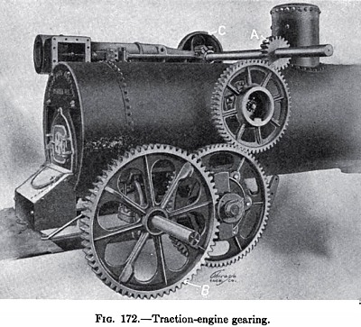

      The transmission mechanism delivers the power from the engine to the traction wheels which must revolve slower than the engine crankshaft. The transmission system of a steam traction engine is very simple and consists of a train of spur gears (Fig. 172). The gear A receives motion from the engine and delivers this through the train of gears to the gear B, which is connected to the traction wheel.

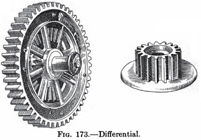

      When a traction engine turns a corner, the drive wheel on the S. outside of the curve must turn faster than that on the inside. If the two drive wheels were rigidly connected, one would have to skid or slip, when turning a corner, and this would throw a great strain on the front wheels and axles. The differential (Fig. 173), sometimes called a compensating gear, allows, if occasion demands, one drive wheel to move faster than the other.
