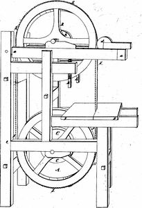

next American bandsaw patent was granted to Benjamin Barker of Ellsworth, Maine, in January of 1836. Barker patented the basic concept of the bandsaw. There was obvious prior art, but before July 1836 there was no review process for patent applications. Barker's machine used a blade 34 feet long, 9 inches wide, and one twelfth of an inch thick, or about the thickness of a thin-kerf circular saw blade. The wheel's diameter was five feet. Notice how the frame of the saw is not a C-frame but more of an I-frame. That reduces the saw's horizontal capacity by half, but with five-foot wheels it hardly matters. The very large wheels reduced the degree of flex experienced by the blade. A good idea but still a dead end.

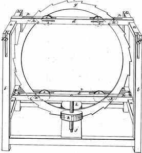

Given the problems with blades, some applied their throbbing brains to alternative approaches to making a continuous-cutting scrollsaw replacement.
Here's one solution from 1838:
This type of saw was common enough to merit its own name: the annular saw. (One was manufactured by
Goodspeed & Wyman ca. 1870, just in time to be knocked off the market by the newly practical bandsaw.)

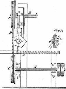

the next true bandsaw patent came in 1849, granted to rule maker and sawmill maker
Lemuel Hedge. This design looks pretty normal. The saw has upper guides, albeit odd-looking.

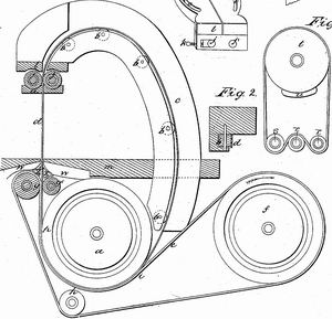

In 1851 Hedge received
another bandsaw patent, this time for a radically different design.
There are two odd things about this saw. First is the use of several small wheels instead of a single upper wheel. Second is the driving mechanism: a secondary belt wraps around the bottom of the lower wheel and drives the blade. The intent is to only tension the straight part of the blade that is in the cut; the rest of the blade is untensioned. Interesting, but a genetic dead end.

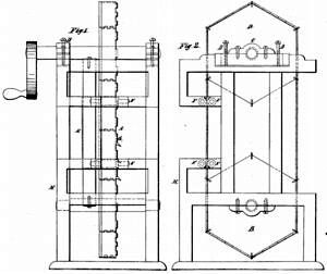

Another dead end is this
decidedly odd idea patented in 1858 by one Harvey Brown of New York City:
The "band" is made of a series of inflexible links with hinged joints. I don't understand how this saw could work. As the hexagonal wheels rotate, the blade is going to move back and forth laterally. There are upper and lower blade-guides but the geometry just does not work out.

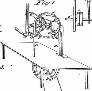

Next in our bandsaw freakshow is a bandsaw that uses a chainsaw blade,
patented in 1863 by New Yorker George Kammerl:

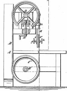

Paul Pryibil patented some bandsaw features Pryibil's patent covered an upper blade guide design that looks rather impractical because it consumes too much vertical capacity. More importantly, the patent covered the use of a spring to make a yielding mount for the upper wheel. The patent's importance in itself is modest; we skipped over some more important bandsaw patents because of insufficient entertainment value. But Pryibil's patent is notable because it is, so far as we know, the first patented bandsaw that actually saw commercial production.
Although the saw above does not exactly match the patent drawing, it uses the patented upper-wheel mount and carries the 1866 patent date.
