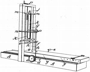

In 1806,
Joseph Mott of Vermont patented a machine for planing boards out of wind. Mott's planer used a fixed-knife cutterhead that is essentially a hand plane suspended above the board to be planed. The board is dogged to a traveling carriage, which is the only part of the planer that is powered.
Mott's planer would have been only partially effective at flattening boards because the action of the cutter would push the board downwards while it was being cut, and it would spring back afterwards.

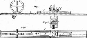

The first commercially successful machine for flattening the face of a board was the Daniels planer.
Patented in 1834 by Thomas E. Daniels of Worcester, MA, this machine had a footprint more than twice as long as the longest board it could flatten. The board to be planed was placed on the carriage, and then shimmed so that it could not rock or flex. The carriage then moved under the horizontally-spinning cutter, which produced a flat upper surface. The Daniels planer was very successful, and was produced by several different makers:
The Daniels planer was an enormously successful design. It was partly obsoleted by Climer and Riley's 1866 invention of the modern jointer, but even after that time the Daniels planer was used for certain specialized tasks, such as planing masts and other timbers too heavy to feed across a hand jointer. Richardson, Meriam & Co. manufactured a Daniels planer until the end of World War I. Even so, only a small handful are known to have survived to the present day.

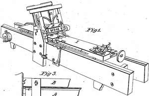

In 1854 Solomon S. Gray was granted a
patent for a machine for planing lumber out of wind. The machine was similar in form to the Daniels planer except that it used a cylindrical cutterhead. The board to be planed was held by a clever dogging arrangement on each end. Instead of presser bars, which have the undesirable tendency to push the board flat before it is planed, Gray's planer had a cutterhead designed to prevent the board from lifting up as it was being planed.
Gray and another Boston machinist, Solomon A. Woods, formed
Gray & Woods to manufacture the planer. Gray's design must have been commercially successful because the patent was both extended and reissued. The partnership lasted until 1873 when the firm became known as the
