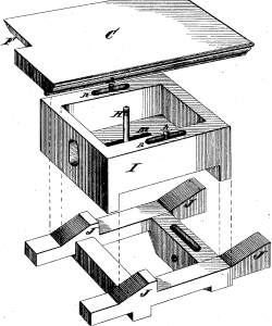

The 1866
1866 Climer and Riley patent represents the genesis of the modern jointer. John D. Riley and Henry Climer, both of Cincinnati, described a pair of tables—an infeed table and an outfeed table—separated by a cutterhead.
The outfeed table's height is adjusted to be flush with the top of the cutterhead, and the infeed table's height is somewhat lower. The difference in heights is exactly the depth of cut.

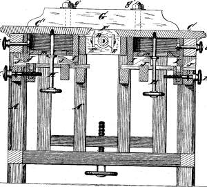

One machine builder who saw the benefit of the Climer and Riley design was
Carey & Harris of Lowell, Mass. They
patented an oddball depth-of-cut adjustment that was manufactured for a few years:
In 1875,
W. W. Carey patented an improved table adjustment mechanism.

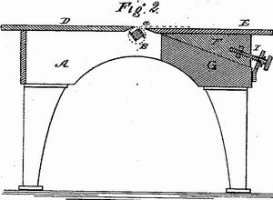

Jonathan Grosvenor's 1874 patent is noteworthy because it covers the basic wedgebed design, which remains the most popular jointer design over 130 years later. It seems that
Jonathan Grosvenor never manufactured his jointer design, probably because he could not get a license from the owner of the Climer and Riley patent,
Bentel, Margedant & Co. In any event, Grosvenor is best remembered for his innovative tablesaws and spindle shapers.

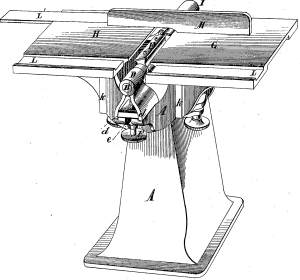

In 1875, George Passel and W. H. Doane of
J. A. Fay & Co. http://datamp.org/displayPatent.php?id=8390patented yet another table adjustment mechanism. Their patent is of note because it is the earliest image of a pedestal-base jointer we have found, and because it was the first in a rapid series of patent improvements that Doane and various co-inventors made. J. A. Fay & Co. was making both dedicated jointers and universal wood workers.
