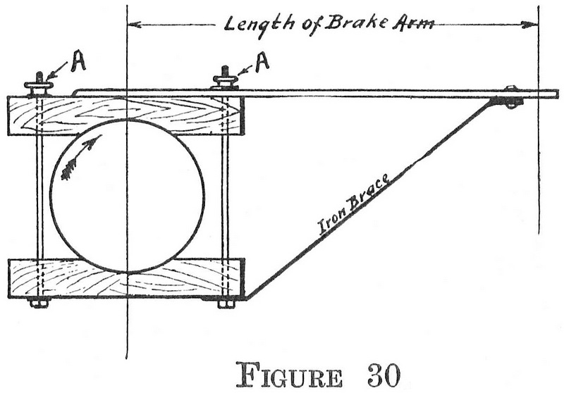

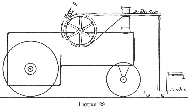

Measuring the Horsepower of an Engine — There are two common methods in general use for determining the horsepower of an engine. In the first method a Prony brake is used, and in the second, an indicator. Brake horsepower shows exactly how much work the engine is doing at the flywheel, while the indicator shows how much work is done in the cylinder. Indicated horsepower is always greater than brake horsepower, because the work done in the cylinder shows the total amount of work done by the piston, and includes not only the work done at the fly wheel, but the work necessary to run the engine itself as well.
      An indicator is an expensive and delicate instrument, and the services of an experienced man are required to secure satisfactory results. A brake is something that any engineer can make and is easy to operate. Figures 29 and 30 show how it may be constructed, and the following directions explain how it should be used and how the horsepower is figured.
 Figure 29 |
 Figure 30 |
1. Place the brake on the fly wheel in the position shown, with the nuts A loosened so that the brake hangs free on the wheel. Now find out how much weight the brake exerts on the scales. This weight is constant and must be subtracted from all of the scale readings.
2. Oil the rim of the fly wheel, so that it will not stick to the brake, and start the engine. Now tighten nuts A as much as possible without slacking the speed of the engine, thus putting a load on the engine. In running it is often necessary to keep a stream of water on the wheel to keep the brake from burning.
3. Find the average speed of the engine per minute during a run of at least ten minutes, and the average load on the scales. Subtract the weight of the brake on the scale, as found in paragraph 1, and the result will be the load exerted by the engine.
4. Now measure the length of the brake arm in feet, and proceed as follows: Multiply the length of the brake arm by the average load on the scales, and by the average revolutions of the flywheel. Then multiply this product first by 2, and then by 3.1416. Divide the final product by 33,000, and the quotient will be the brake horsepower.
Example — Suppose in a certain test, that the brake arm was seven feet long, the load on the scales 150 pounds, and the average number of revolutions 240 per minute; what is the horsepower of the engine?
Solution — (7×150×240×2×3.14160)÷33,000=47.7 horsepower — answer.
