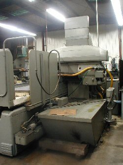

Thompson Surface Grinder ca. late 1950's. Dial on lower center raises/lowers stone by .0005ths by mechanical linkage! Center levers control speed of travel and incremental change per pass. Push buttons run magnetic lock.
Backside showing fluid pipe; 50 HP motor is in center right.
Grinder chuck; note magnetic coils in surface
Wheel is about 24d.by 6"

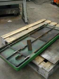

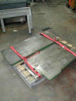

Tables arrive on pallet.
Bottom of in-feed. Trued up only slightly bearing points with stone and long straightedge.

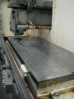

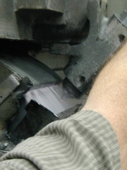

Grinder in action at beginning of pass. Magnetic table moves laterally, while wheel moves in and out and up and down, perpendicular to table. Note tiny jack holding up rabbeting arm to maintain flushness to table.
Contact with table. Lots of water, but heat still caused table to bow up in center as expected. Solution was to let cool, then make lighter, faster passes to get to final flatness.

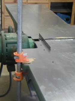

Holding up one side of table with pipe clamp. Screw side of clamp under table allows minute adjustment.

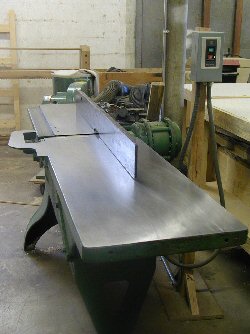

Tables back in place and looking great.
The machine works great now. I was really afraid that the grinding would make it look too new and detract from the vintage-ness of the machine. It just looks like an old one in really good shape now.
